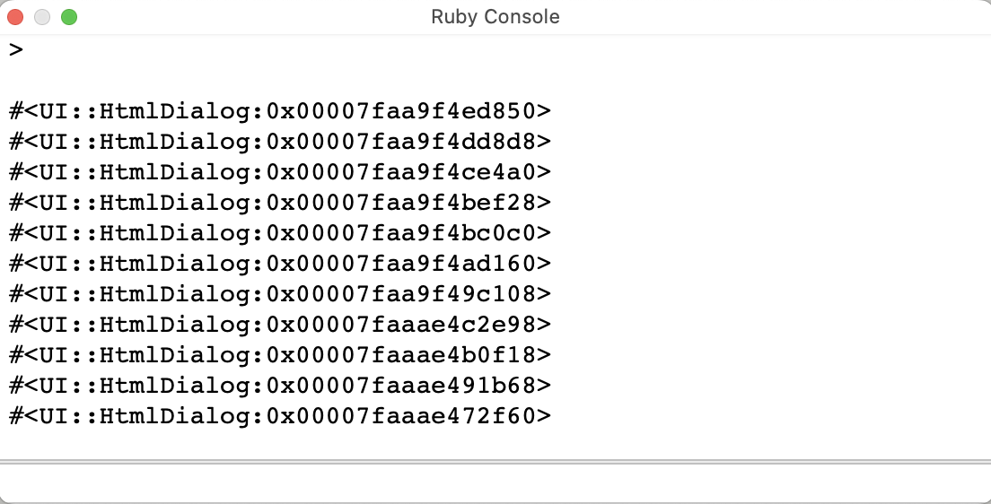

Maybe this is happening because I am calling a class named Main.new each time I activate the toolbar button?
Bellow is my initialize method…
module ModuleName
class Main
def initialize
@dlg ||= UI::HtmlDialog.new
puts @dlg
# Because each time the tool activates the value of @dlg changes
# and the if condition always returns false.
if @dlg.visible?
@dlg.bring_to_front
else
@dlg.set_url('https://www.sketchup.com')
@dlg.show
end
end
end
end
And, below is a sniped of code where I create the toolbar and command to activate the Main.new
# UI Add Toolbar
tb = UI::Toolbar.new NAME
cmd = UI::Command.new(NAME) do
Sketchup.active_model.select_tool Main.new
end
tb = tb.add_item cmd
In your case you are using an instance variable within a class. So every instance you make of Main will create it’s own UI::HtmlDialog.new. Notice that in the example I posted I use ||= in the context of a module.
Your code shows that your tool holds the reference to your dialog. You button logic creates a new instance of the tool every time you click it. But it since you only want one instance of the dialog you need some other factory method to ensure you have only a single instance of the dialog.
