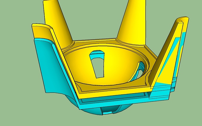

The parts are overlapping and the colors of the faces (same place in space) are z-fighting.

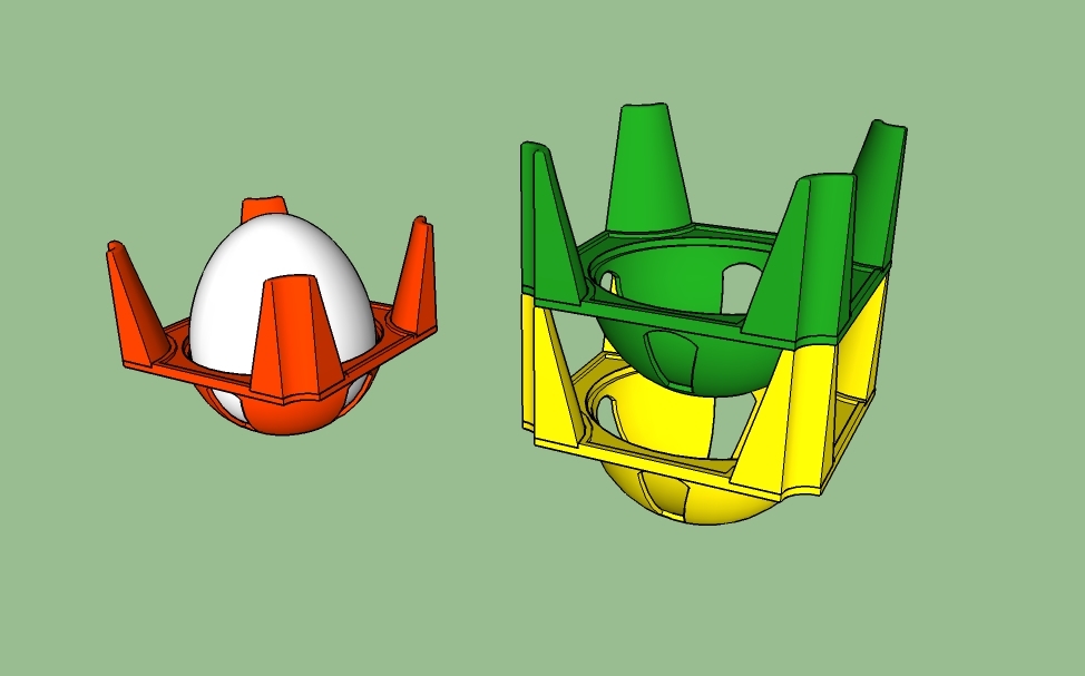

Why do You put 4 parts together in a way which is impossible in reality?
in real tray are place each other same way.
Thanks for posting that image @miller. I was wondering the same thing.
What you’ve drawn won’t fit like that because the sides are too close to vertical. Actually look at the egg trays you are emulating and see how they are made.
For anything to nest, the inside and outside must be similar in shape. The four corner posts in your model have a sloping cone shape on the inside and a cylinder plus flats on the outside.
