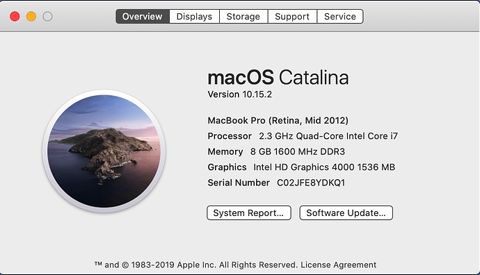

Same computer. Without SketchUp running:
After starting SketchUp:
