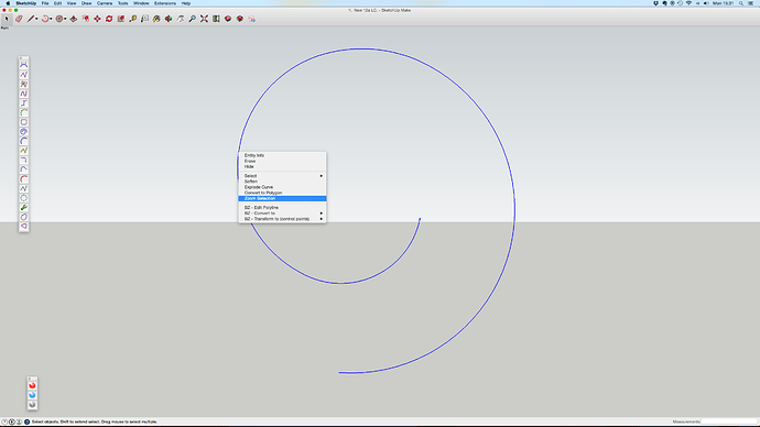

Welded a curve but it won't divide into segments

According to your screen shot you already have the Plugin Store extension installed. You could have used it to download and automatically install Bezier Spline.
The contextual menu does nt give any option of convert to polyline.
What tool from the Bezier Spline set did you use to draw the curve? From the Context menu, it doesn’t look like you used any of them.

No, i did however ask whether i may have to do that, i was hoping this pluggin would be able to convert what i had drawn to a polyline then divide into equal 50mm segments. It seems i may have to re-draw? How can i do that with accuracy?
