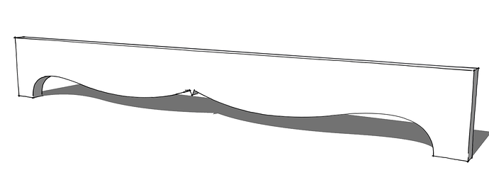

FWIW, here’s an example of curves drawn with FredoSpline using the Classic Bezier Curve option.
Yup - that’s along the lines (pun not intended) of what I am shooting for. Again, thank you DaveR.
