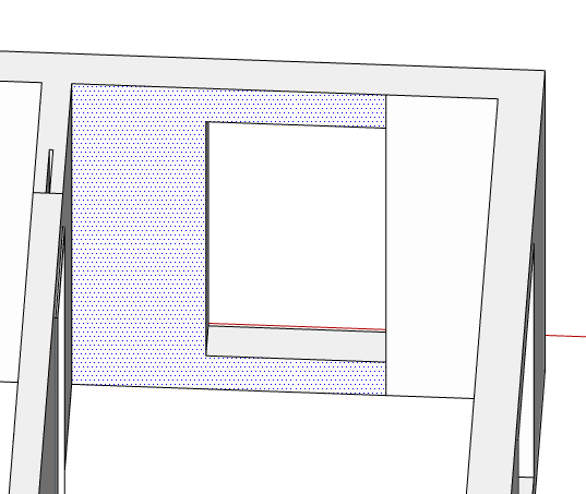

I am learning how to create a 3D model, in particular drawing windows and doors. I noticed I had lost one of the inside walls on the window to the left of the front door entrance - screen shot attached. When I try to go into the wall to draw it and recreate the face, the whole wall disappears. I drew it outside of the wall grouping to create a face for reference of what is missing.
Any advice is recommended. Thank you!

I don’t see the problem. you’re missing the bottom line, just enter the group, draw the bottom line and voilà.
you can then get rid of the 2 lines I deleted.
Thank you. Had tried that multiple times and each time when I deleted the two small lines the whole wall deleted. I’ve got it working now. Appreciate your swift response.
