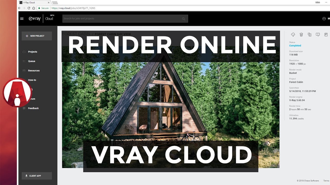

If you’re planning yo upgrade just for faster render speed in Vray then I recommend you try Chaos Cloud (Vray Cloud) instead. It’s just way more convenient. Especially when you can render up to 10 renders at a time, and this is all cloud based so you can still use your computer. 100 credits are $100 I believe. My 1920x1080 renders with 10+ render elements take anywhere from 1 to 3 credits to render. So that’s only 3 dollars per render which is worth it if I do it for clients. Plus I don’t have wasted time that I can work on something else while waiting for the renders
Edit: here’s the video on Vray Cloud if you’re not sure what it is.
