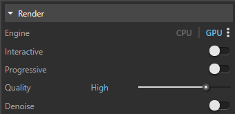

On a GPU render the geometry compilation. is loaded directly into video memory.
Open the messages window from the VFB and follow the process, see if you spot some errors.
OK, found it.
Next will not render fur unless a material is applied to the base material or a material to the fur object on GPU. This may be a bug, Ill report it.
try it out, just stick the chair material on the rug.
Actually, this appears just to be related to a scene created in an older version of sketchup & VRay.
works fine in a new scene with no material applied.
@bifterx, great, it was that, thank you so much, good investigation.
