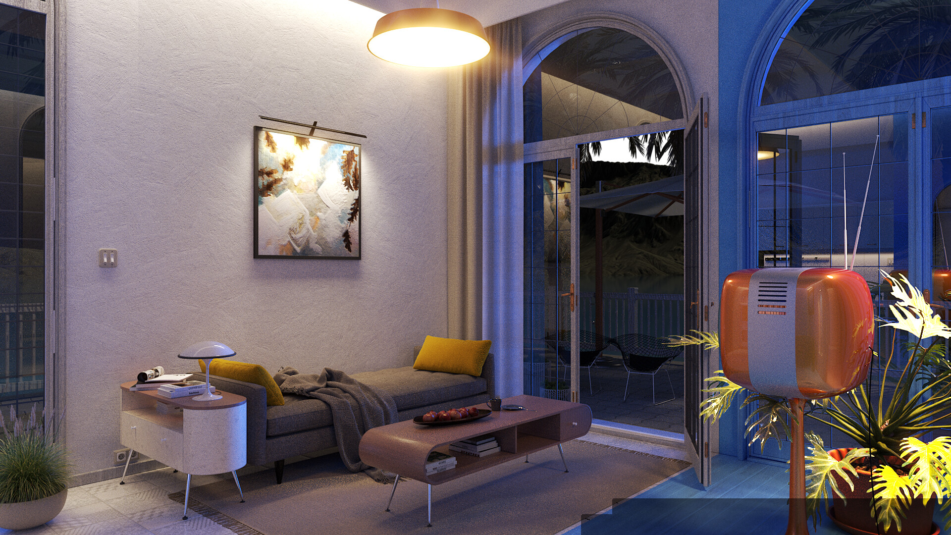

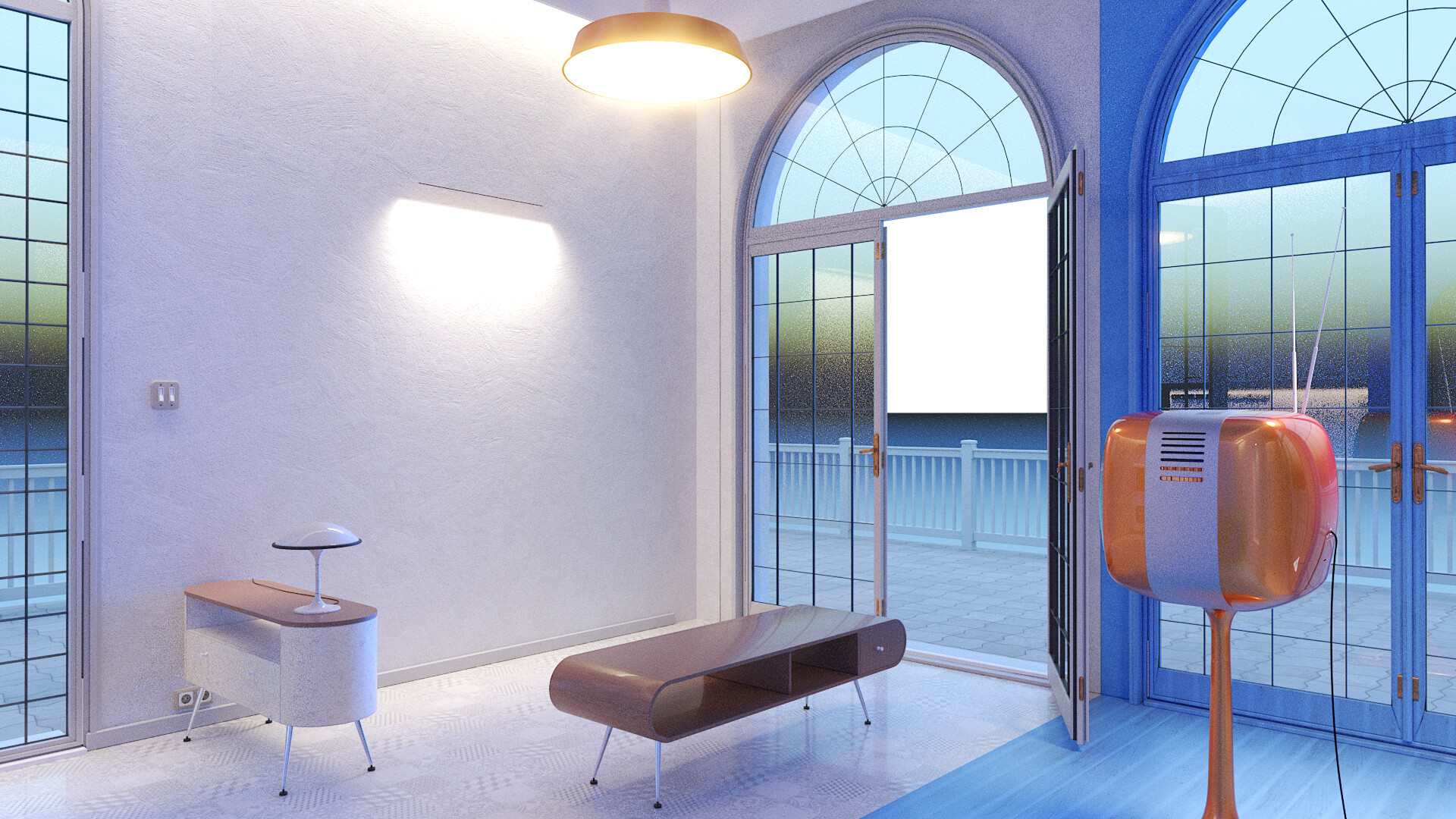

I am still trying to get my M3 Pro Max to render like my M4 Pro does. I even saved out the settings from one to the other, but the results are quite different. Any ideas what might be wrong?
You will notice that in the second image, from M3, a lot of objects are missing. What could cause that?
These are both done with SketchUp 2023, so it’s nothing to do with new graphics engine. The SketchUp document looks the same in both cases.
I noticed with another model that models coming from ChaosCosmos might have to be redownloaded when the file is transferred to another computer.
I’m guessing they are chaos cosmos assets and you haven’t downloaded them on one machine
They are V-Ray proxies (vrmesh). If the SKP is still located in the directory with all the assets, they should actually be found.
Btw. did you just reset to defaults and set the resolution or did you change any
other parameters?
Why should that be the case? It’s just a scene that is getting rendered like any other scene. The only thing you could say is that it’s designed to only take a few GB of memory to be compatible with many systems, but this is not relevant to compare the CPU or GPU performance.

Thanks, I had downloaded the folder on one Mac and copied the folder to the other Mac. I downloaded the folder on the other Mac now, and things are behaving better.

I only clicked the reset button, changed CPU to GPU, chose M3 as the GPU, and turned off progressive. The rendered image size and quality are coming out with the default values (medium and 1920z1080 I think).
Actually, I see that the file opened on my M3 wanted to do 800x450, and rendered very quickly. I set it going again at 1920x1080. I had better check the quality setting as well.
The original file had the quality basically set to “high”, but had
  • changed the Min Subdivs to 1
  • changed to bucket mode, but with bucket size set to 16 instead of 32
  • Volumetric environment enabled (aerial perspective with range 1000, height 100)
  • displacement disabled
  • denoiser enabled.
If you change to “progressive mode”, the setting “rapid” for “update effects” could result in higher render times.
Thanks. In checking the quality I could see that M3 was set to Medium, and M4 was set to Custom, very close to the High+ end of the slider. I am testing High+ on M3, and will go back and try High+ on M4. Or I might export the M3 settings and use those on M4, to make sure everything is the same.
My main goal at the moment isn’t to find the fastest way to get a given size and quality, it’s to see how M4 does compared to M3, with the same settings.
I am aware of that. I just wanted to make it clear that the settings are significantly different after the reset. :wink:

I did one more test, where I exported the settings from M3 and used those on M4. The final image still looked different, but at least nothing was missing in either render. So, not a completely fair test, but the M4 came out 40% faster.
