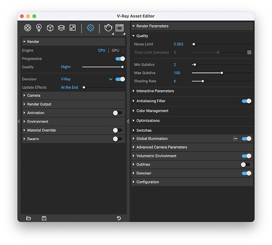

There is also this, which Iāve never adjusted:
I note when I switch between GPU and CPU the Max Subdivs change⦠but Iām not an expert - I work my way through and mainly use ChaosCloud for my work, although Iāve been very happy with my M2 Max with 64GB compared to my 2019 iMac.

It must mean your settings are not the same.
One is doing a bucketed render - RETRO
The other is doing a progressive render , which is the recommended option nowadays.
Because the sample SKP file itself contains render settings , from many versions ago, Iād hit the button to reset the render to default to keep everything using more current settings.
Where is there a button to reset the render settings?
It looks like a ārefreshā button in the bottom right of the asset editor when you are in the render settings.

Uncheck the āProgressiveā switch that is topmost in the Asset Editor.
I donāt know about @Elmtec-Adam 's recommendation, but IMO āProgressiveā is slower.
