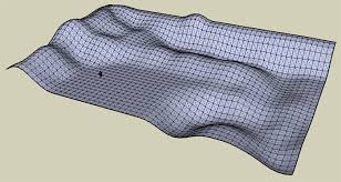

put some surfaces in it: it’s just wire-frame lines with a bulb.
(Select all the lines, then use Draw | Sandbox | from contours - then you just need to tidy it a little bit.)
I guess it’s not good solution, I want this lamp to look like this:
http://mesmetric.com/products/wnetrza-domowe/oswietlenie/lampy-wiszace/12643,vertigo
not like this:
In that case, you need to actually place some “wire” around the lines - just draw a circle of the desired thickness and use the “follow me” tool for each of the lines. (I’m sure there is a plugin that would help)
