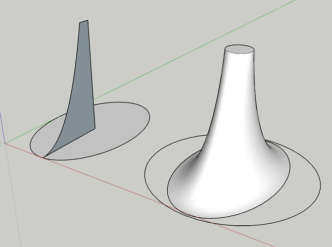

You’r right it’s an ellipse and I would like to do an horn but when I rescale the base only the base is rescale, not the side of the horn.
Can you send the result of your rescale ?
TRUNCATED CONE 2.skp (190.2 KB)
Evidently you’re not selecting the right stuff before scaling.
TRUNCATED CONE.skp (343.0 KB)
you work is perfect. I can’t do that. After “follow me” the base become multi segment. It’s why I can’t resize correctly. I don’t know how your base stay a coherent circle.
That indicates you need to learn how to use the Select tool properly.
You’re using an ancient version of SketchUp. SU2018 doesn’t explode the curves it creates in Follow Me.
Hmm, interesting to know that, thanks!
I don’t know how I can use the select tool unproperly.
Thank you for your help.
Read and watch the video.
In particular here, you can double click on the bottom face to select the face and all its edges, then type s to pick the Select tool, and scale away.
Or view it from front or side then ‘window select’ left to right round the base only, to achieve the same selection.
