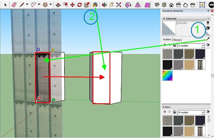

I have a problem texturing an object using only one texture for a 3D object
(In flight simulator one texture is required)
Is it possible to use a program or plugin to remember the texture positioning settings for a given part of the object and transfer or clone this setting from the texture to another part of the object
I will try to explain it with examples
this is the part of the texture that I would like to apply to different elements in the object
After positioning it on the first object and positioning the texture I try to read the texture using the picker (1) and fill the texture with the bucket (2)

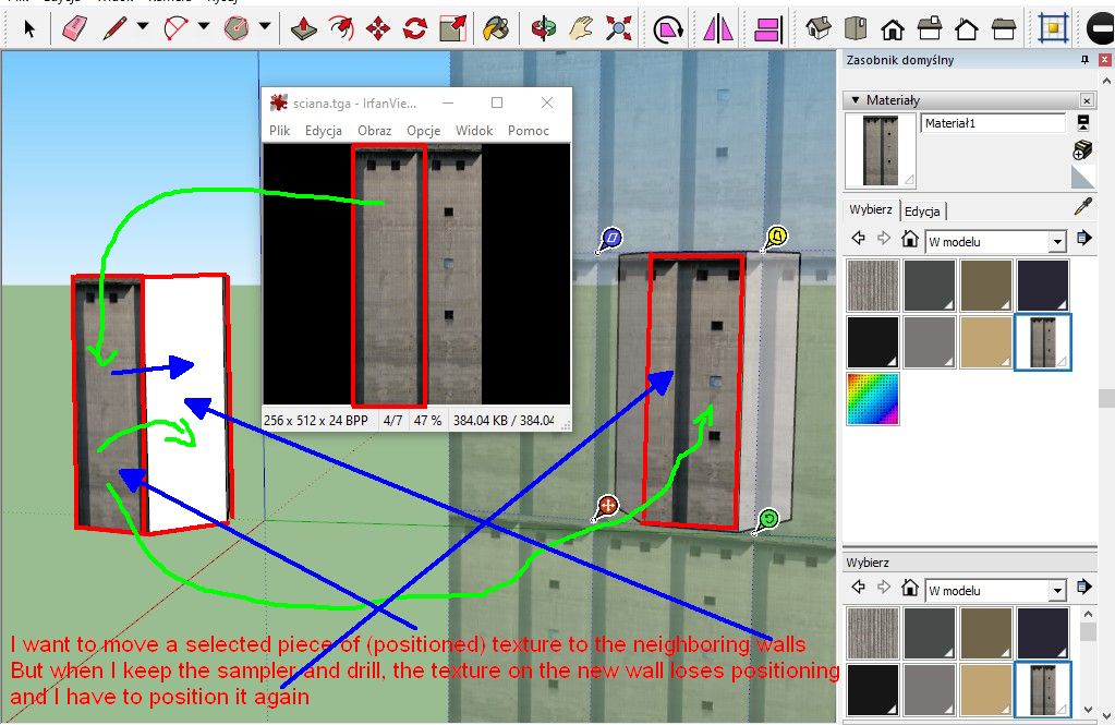

and I get the texture in the first position which works very well with several textures
but with one texture I have to re-set the positioning which becomes troublesome with more or small elements
I am aware that the picker and bucket tools work correctly
and transfer the texture in this way unchanged (without positioning)
But I would like to transfer the texture with the texture positioning settings so that the pin settings are remembered
If this is not possible in SketchUp itself, maybe there is some plugin (free or paid) that will do it
Thank you very much for any tips
