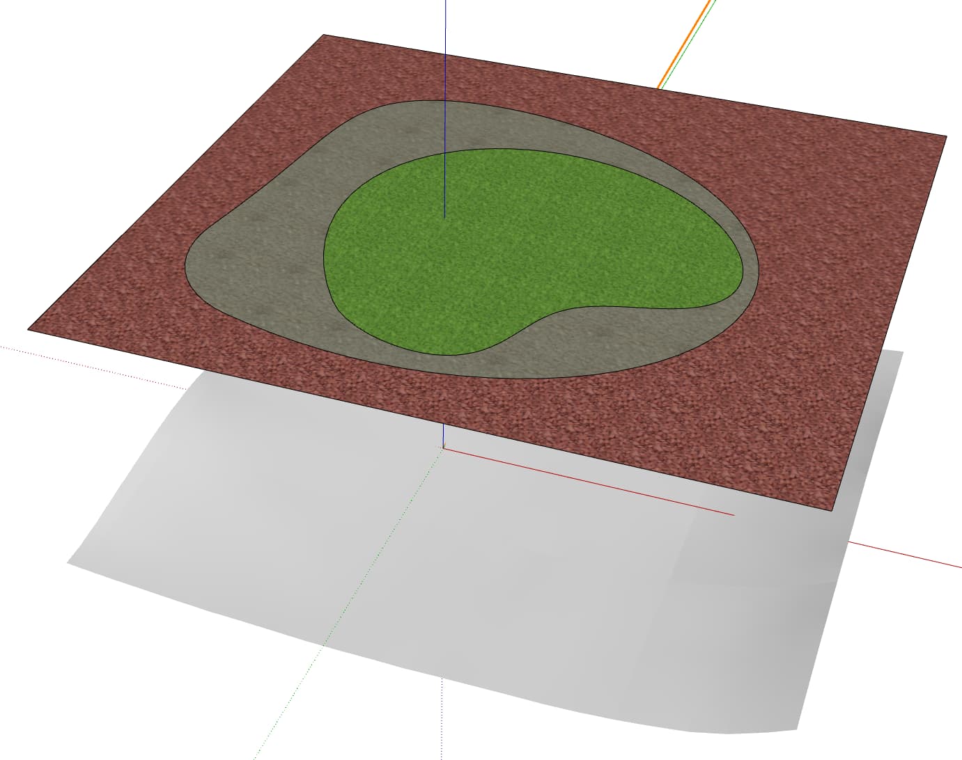

An alternative would be to draw a large rectangle above the terrain and outline the different texture areas on that. Then use the Combine Textures feature to combine them into a single texture that you project onto the terrain.
