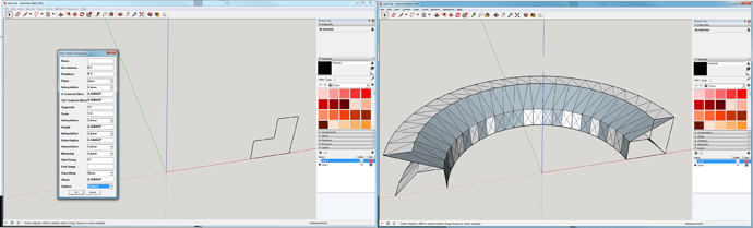

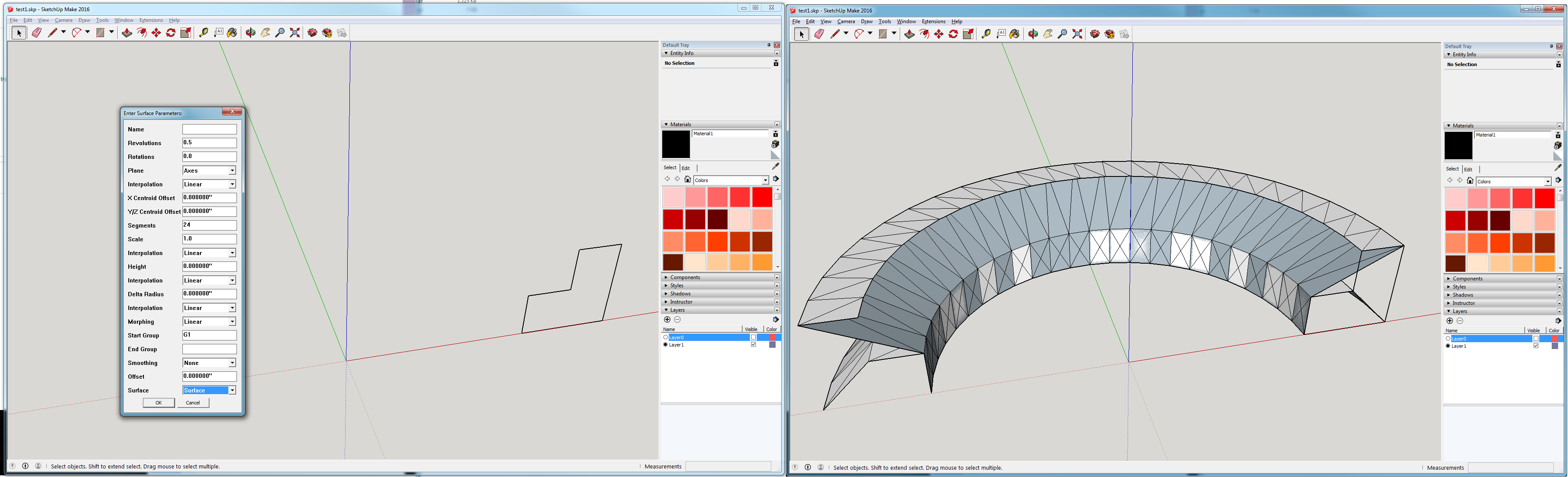

I did run into a bit of an issue that I can’t seem to resolve with it. If I start with an L-shaped figure and use the following settings:
I get a result with some exterior faces missing and some diagonal interior faces. I’ve even had issues with a square where one of the 4 side faces is missing and the semicircular extruded shape looks like a channel and not a square, curved pipe.
I’ve tried playing around with the various inputs and searched for similar issues on this forum and on the web, but to no avail. Would anyone have any suggestions?

Thank you so much for the replies.
The ‘L’ is a 10"x10" square with a 5"x5" square removed. Is that large enough?
Here’s a better picture of the before and after that I’m seeing:

The plugin requires that you create geometry “head-to-tail” before grouping. Any editing before you group it will result in possible corruption of the input geometry. In your model, I deleted the Layer 0 MakerBot geometry and traced over your existing L. Then I used the Spirix Create Group function to create a second group G2. The face disappears when the group is created.
Ah. That was it. Thanks so much for the help!
