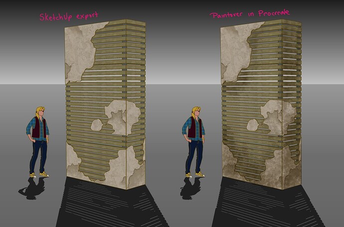

Now? I have done my last 8 set designs in SketchUp for iPad, and then because I still feel like the textures are inferior most of the time, I do one of two things.
I either take them as images into Procreate and direct paint on them like I used to do in Photoshop, or I create a texture in Procreate specifically for the “wrap” of each piece and then use that as the material in SketchUp.

I have to say I’m addicted to SketchUp, and like @RTCool says above, I could not be any more pleased with the iPad version, especially with the Pencil, and Procreate, and Mental Canvas.
It should be noted that I also struggle with the desire to knock back the “squareness” of almost all my models. It’s the decades of theatre making me wish I had the digital equivalent of a can of glossy woodtone spray.
I have had great success using the freehand tool to draw new edges on square structures, then hide or soften the original edge. Just that minor adjustment has made a huge difference in allowing my artistic sense to accept some of the more simple textures right in the program.
I am very much looking forward to the export directly to procreate working. I think that will change my entire workflow in an awesome way.

I really like the after-touches in Procreate. This could work to add decay and dirt and make better use of my neglected HUION.

You might not actually enjoy the iPad version of SketchUp, simply because you’re already proficient on the computer. I stated with iPad, so the interface seems intuitive to me, but from what I gather by reading posts here in the forum, if a person is used to clicking without dragging, the pencil mechanics of the iPad are maddening. There are many proficient users here that have iPads who can probably speak better to that. I do know that even though I have the Pro on my desktop, and have followed many tutorials and downloaded extensions, etc… I prefer the iPad, probably because it’s where I started.
The other program… Procreate… is also exclusive to the iPad, but it does work on older models of the iPad, and last I checked it was cheap. I think I bought the lifetime license for 10 dollars, but that was probably 8 years ago now.
Any drawing program with layers and the ability to import PNG files would technically work. I still have a monthly subscription to photoshop because I have had for a long time, but with the latest updates to Procreate, I don’t think I’ve even opened it in the last 6 months. And procreate technically does have the ability to draw right on the models… it just doesn’t work quite right yet. it will though! I have faith!

It sounds very interesting that you can draw straight on the model…
