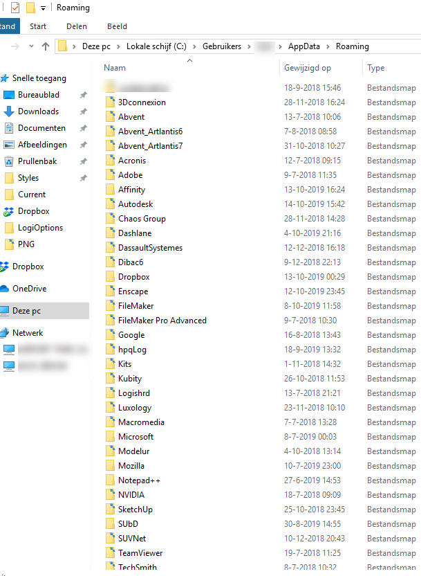

Hi,
SFJI but, I read:
I always figured out that Windows hidden folders were not supposed to be used by a user. Why did the SketchUp Engineering Group choose this location? (just curious).
Thanks.
The now called ‘recovered’ files are not ment to have some sort of version history of your files. Backup is saved in the location of the working model, autosave/recovered files are just there in case if SketchUp splats…
so need not be in a ‘open’ location.
Not uncommon for apps:
