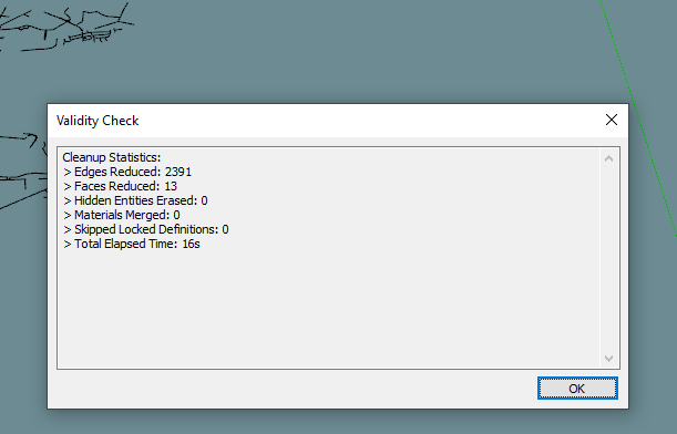

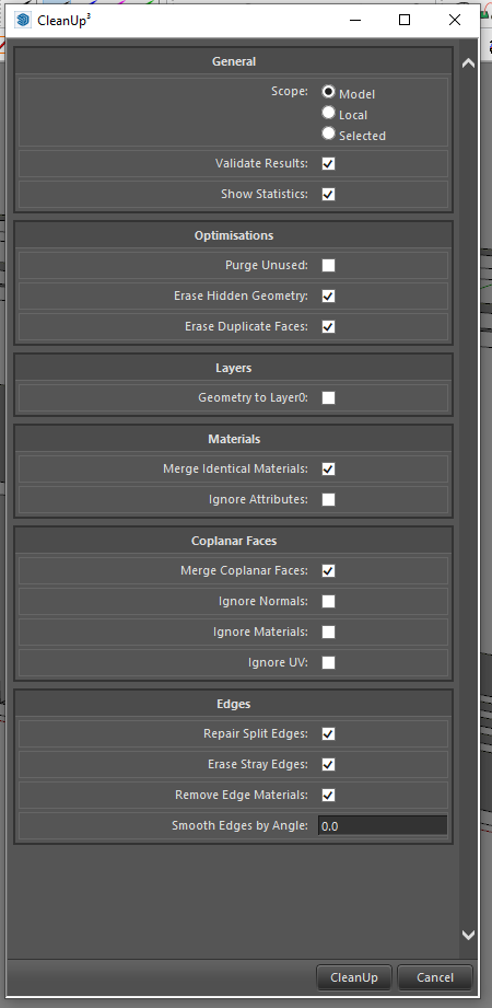

Did CleanUp by ThomThom. Didn’t help.

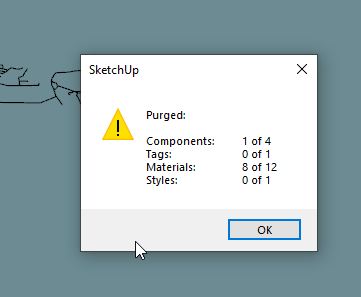

I opened your file on my PC and purged unused. Then I ran cleanup to get rid of a bunch of unneeded stuff. Finally, I exploded the group with no problem. I think the problem is some bad geometry.
