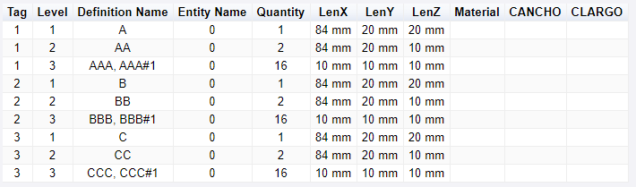

Thanks, yes I can customize my report, but not like in the Sketchup Outliner Format, with a parent component with their child components grouped, with the proper tabulation, when i run the report everything looks like a whole model exploded, yes you can group by levels but with a lot of redundant info.
set a report to be grouped by and organized with custom attributes
the path attribute will show its outliner position
Thank you, @pcmoor, I’ve managed to group parent-child components with custom tags (every component and sub components with the exact same tag or custom atribute), I wish that could be done by default in the future (grouping components with the same root path parent-child), also i want to separate the components in level 3 in rows in a list whith instead of bein separated by comma (Which is better for reading every part with respective leght attributes)
When the definition is reported as attribute (lower section) you can change the settings.

You can move the Definition Name attribute up to “group by” below “level” to be without the comma
Rather than definition, use name or entity, name can be controlled auto from DC and/or entity is the instance name.
So you may have a sheet product 18mm MDF, the definition, ( as #num redundant, not worth tracking, will change on DCs) that can have instances like shelf, side, top… so you use one definition with different purpose as real life. Same face, grain direction, axis

It’s working, thanks, now i have to find a way to group or add tabulation to those level 3 parts, and most important to group things without adding tags or custom attributes to every single component ![]()

Alas, the only way to do that, is to run the report on every single selection of level 1 components, I guess.
In the shared example, the definitions need to be distinguished by naming the instances, otherwise, there is no way of ‘knowing’ how to group by, or to concatenate the results (‘deduped with totals’) in a cell of the ‘tabulation’
One just get totals.
The only attribute that has information about the organization of the model is ‘path’, as @pcmoor mentioned.
If you reduce the level to be reported by only level 3, for instance, and add the path as attribute, you need to distinguish the level 2 components by naming the instances, otherwise it will just report 8 and not 4 and 4.

Also when i use the Path Attribute to group, levels order got reversed by default, wich is solved clicking manually in Path Header ![]()
