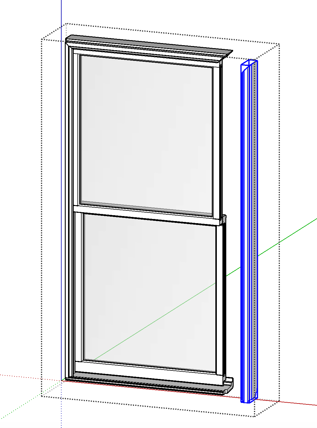

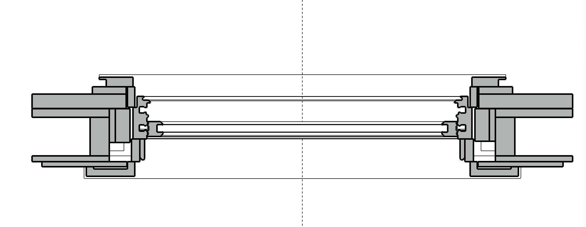

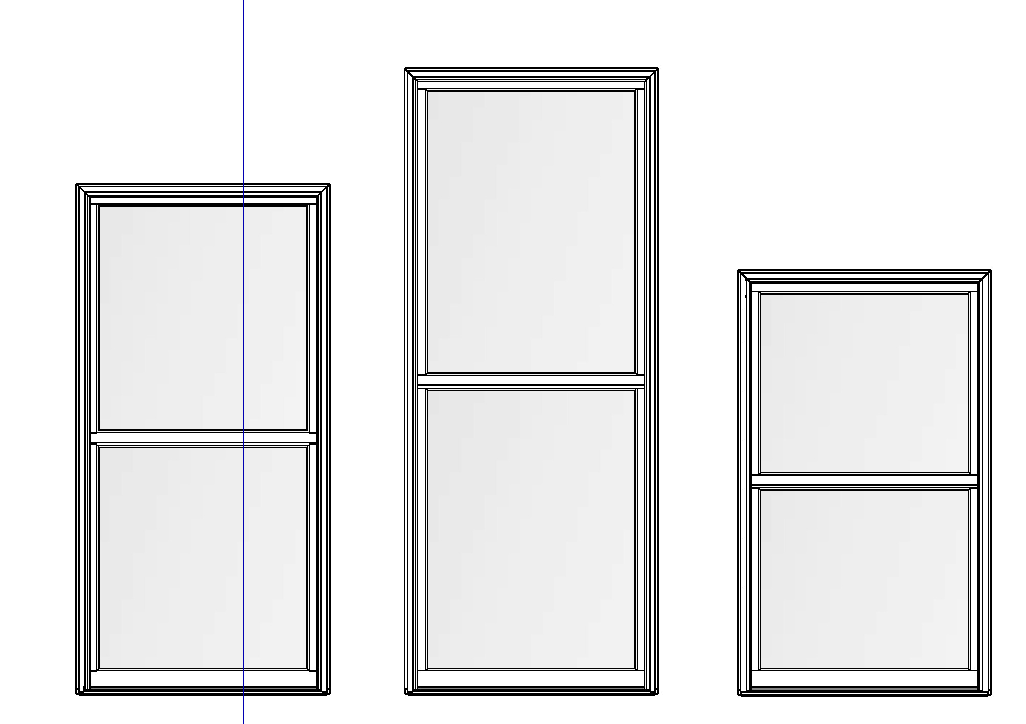

The attached images are included to show what I needed to do (and have done) given the way the frames, sash, etc are modeled. And, yes, I am a crazy person with the details.
Thanks again!

It, as it should, appears that you likely have many “layers” (nested) groups/components in your models.
Don’t know if Fredo’s extension allows you to edit all of them with a single “move” or not. For your sake, I hope so, otherwise, you’ll be repeating your “stretches” over and over for all the various parts.
I think I’d explode the finished window (keeping a non-exploded original) and make it a single group so selecting vertical or horizontal elements as associated entities via a selection window would be easy. I usually make a single window of 1’ x 1’ size, then make numerous copies and stretch them out to the various sizes you want/need, essentially making a library of generic windows.
I find that the detail you have put into your windows will be lost within a large model and will just weigh down the whole thing.
Unless you’re a window mfgr, that amount of detail is not required. Mine are probably only about 5% of yours; a frame, a sash and glass.(mullions if req’d) end of story.
Great drawings though. And I thought I was a detail guy!!!
