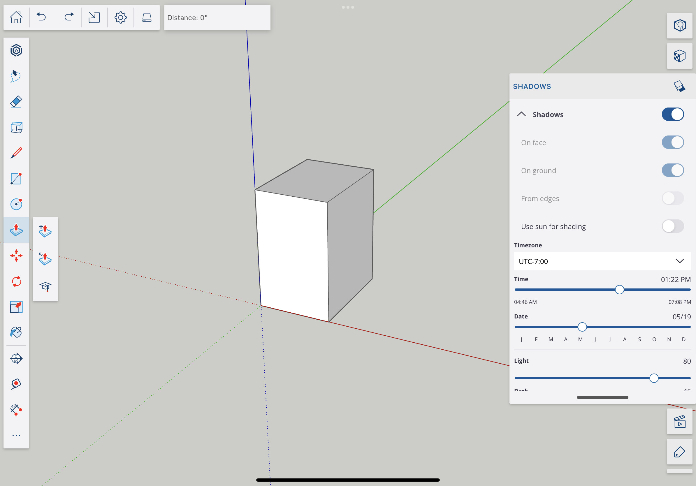

Here is a screen shot showing a simple shape, shadows turned on, and…… nothing.

The on face and on ground toggles don’t show as disabled for me. Are you on version 6.0.7 (1871)?
They have never worked on SU ipad, at least for me. I know they must, as I’ve watched all the videos in search figuring this out! Working on the latest iPad Pro, third gen, and ipad os 15.5

That gave me an idea of something to try. It does seem that sending a model that has shadows turned off, from Mac to iPad, leaves you with a model where the shadow toggles don’t work. I am sure that is a known issue.
That is true…. But…. Starting a file in SU iPad, the toggles don’t work. When i send a file from Mac to iPad with the shadows turned on and styles how i want them, they work in iPad.

Solved it - it’s not just moving the switch to shade, or the line toggle, I need to double tap the switch after I turn it on. Then it works.
Which seems a little weird since it only applies to files originating on the iPad. But at least it works!

Looks like I misspoke too. The model coming from Mac, with shadows off, gave the impression that the toggles weren’t working, but it was shadows themselves that were turned off. Once that was on the other toggles worked.
