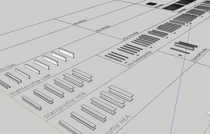

We are continuing our everlasting quest to standardize and simplify our workflow as a team. One of the things crucial to this is that we have standardized components and component groups that we keep using in projects. In order to not “just copy them from old projects” we started building very clean files that are categorized by themes and contain these components. At the moment - if we need a part out of one of these files we need to find the file, open it, select the component and copy it to the file we are working on.
We could of course make a file for each component and add them to the local library but that library is unsearchable in Sketchup. Also, if we’d make separate files certain relations between the components might get lost.

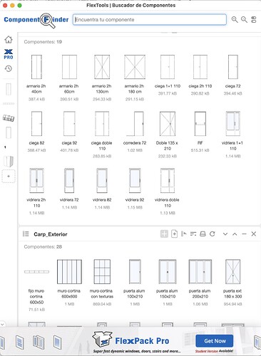

Take a look at Component Finder. It’s the most similar to scrapbooks.
