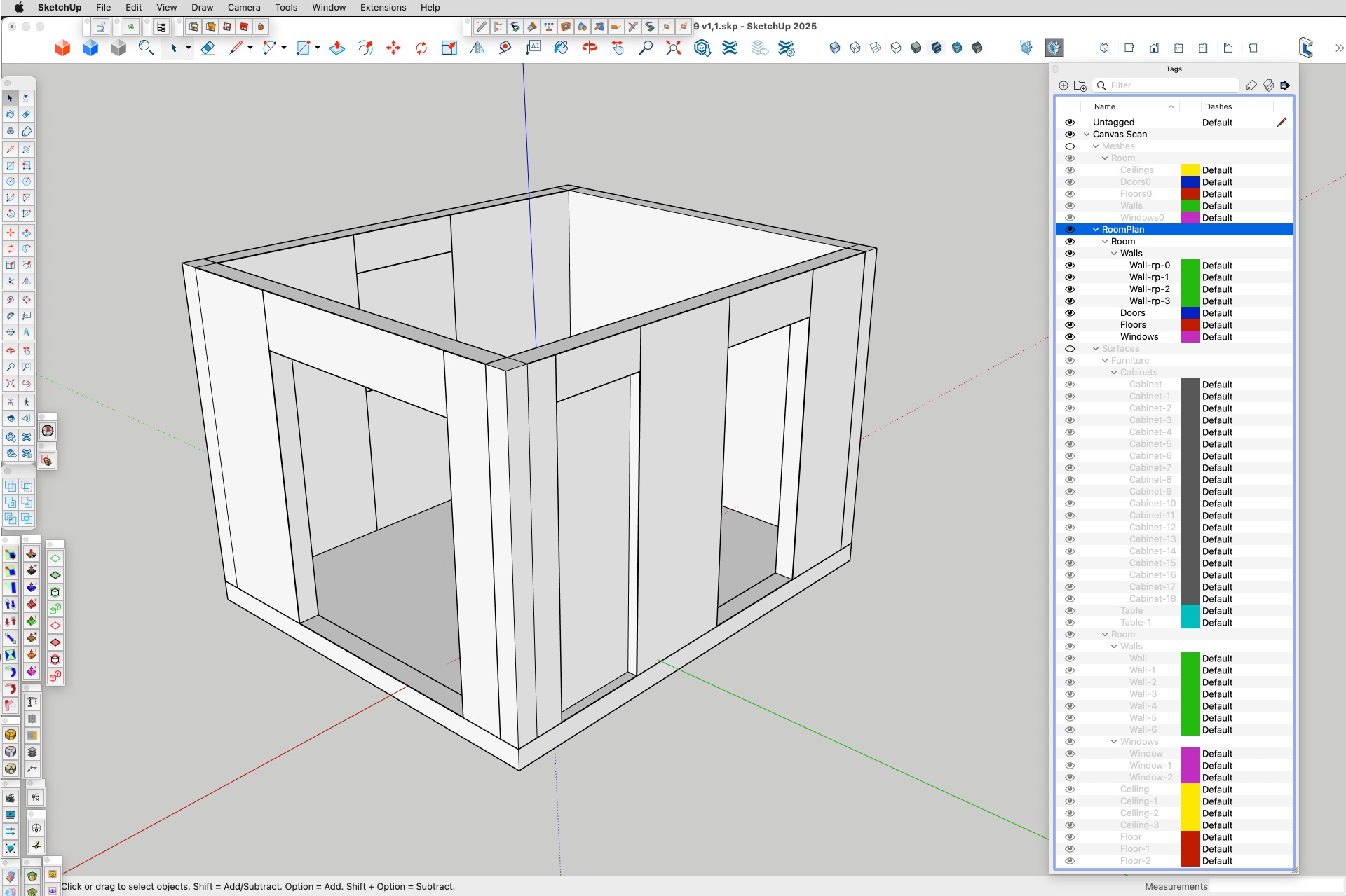

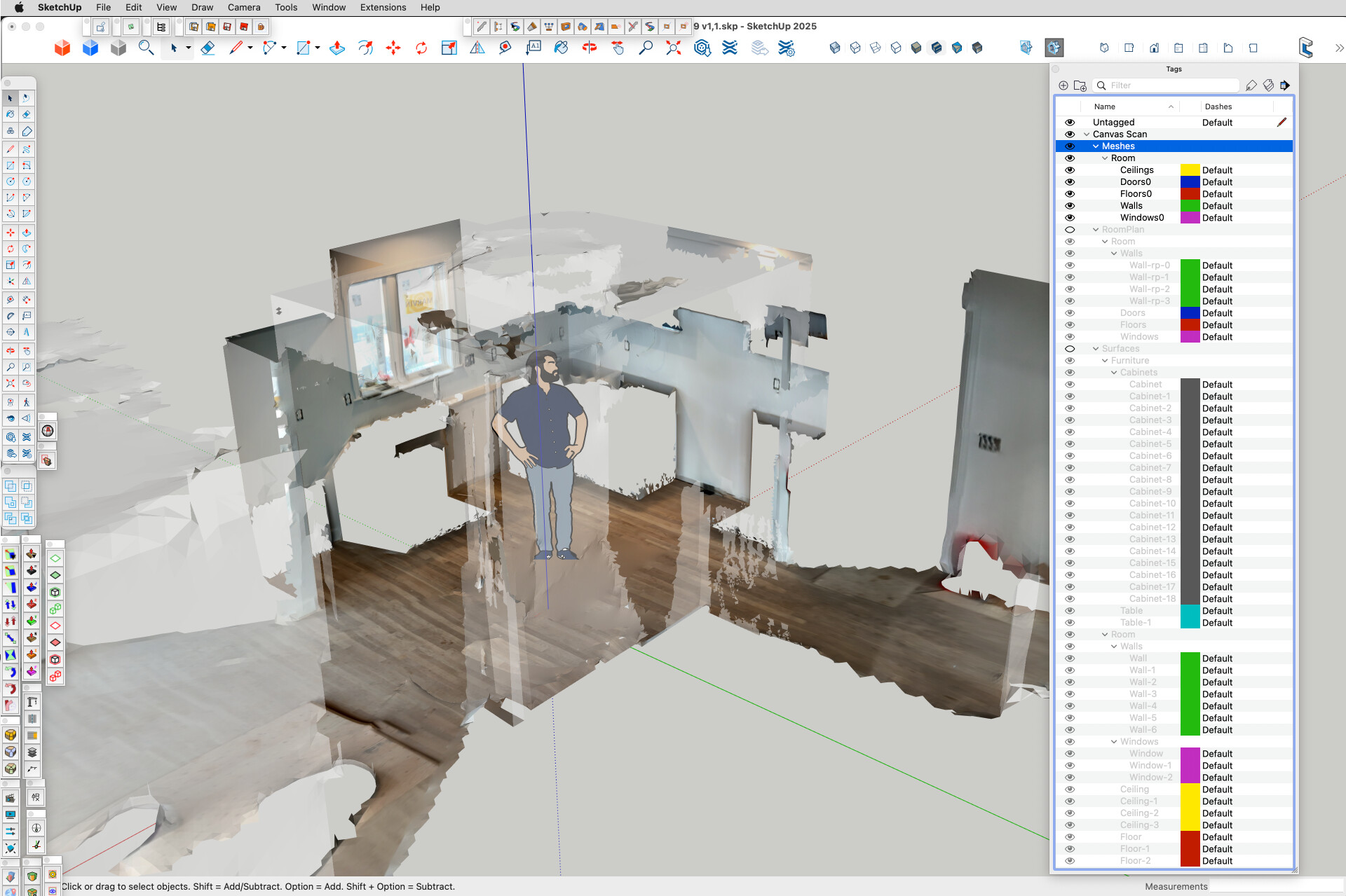

Scan to Design is a part of SketchUp for iPad. If you have a Pro subscription, it comes with it, but you need an iPad with LIDAR capability. It only operates on the iPad, but once you’ve made a file, you can then transfer it to desktop and work on it more there. Since getting a new iPad Pro last November, I’ve only tried it a half dozen times. Here’s what I got with my first try with the Outliner open:
Surfaces:
Abstracted walls auto generated:
Meshes:
It does seem to project the pixels from the photo onto the mesh and the surfaces. I don’t know where, if at all, you can go from there as far as projecting textures goes.

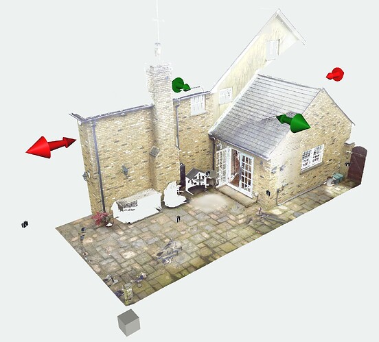

This is an example scanned with my iPhone and exported to dae with Polycam
12_4_2025.zip (8.8 MB)
Another one exported to usdz
18_5_2025.zip (7.5 MB)

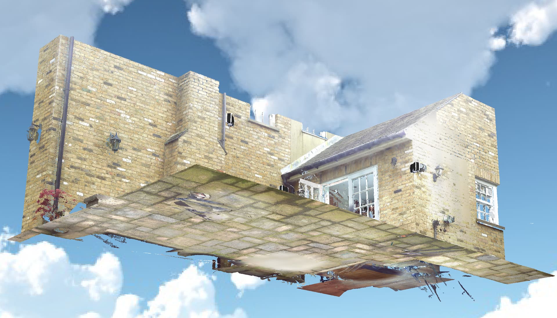

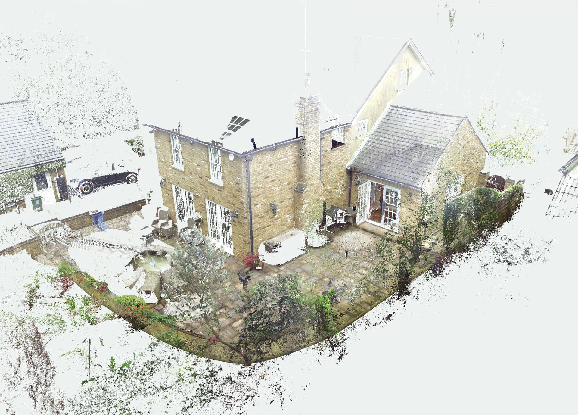

Classified - what does that mean?
The scans were taken with a Leica BLK 360 G2 and the point cloud was edited and published using their Cyclone software.

In a point cloud you can classify each point by scalar factors. It consists of separating the points depending on their type. For example, land, building, vegetation, etc. If it is classified, you can hide part of the cloud to work with the points that interest you the most.
