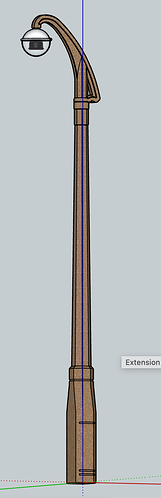

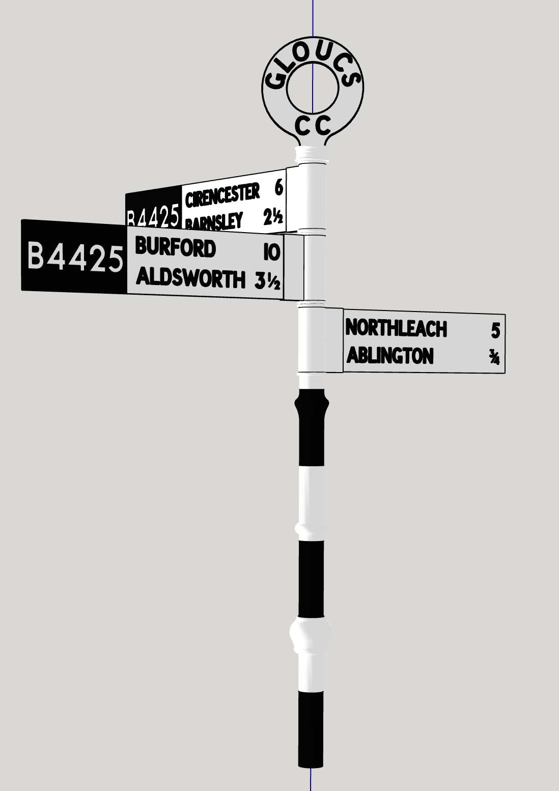

Do you want models with or without materials added? I’ll send some with so you can see what I need to add.
Basically, it’s wood, porcelain, steel/metal and glass/perspex.
I’ll upload: one telegraph pole; one street light and one road sign. The files are too big to upload with this. I’ll send them by e-mail if you let me have your address (probably by We Transfer if too large even for Outlook e-mail).

Completely understand the desire to keep things public. I can take screen shots of the models and post them here if that would be preferable. I’ll do that.
