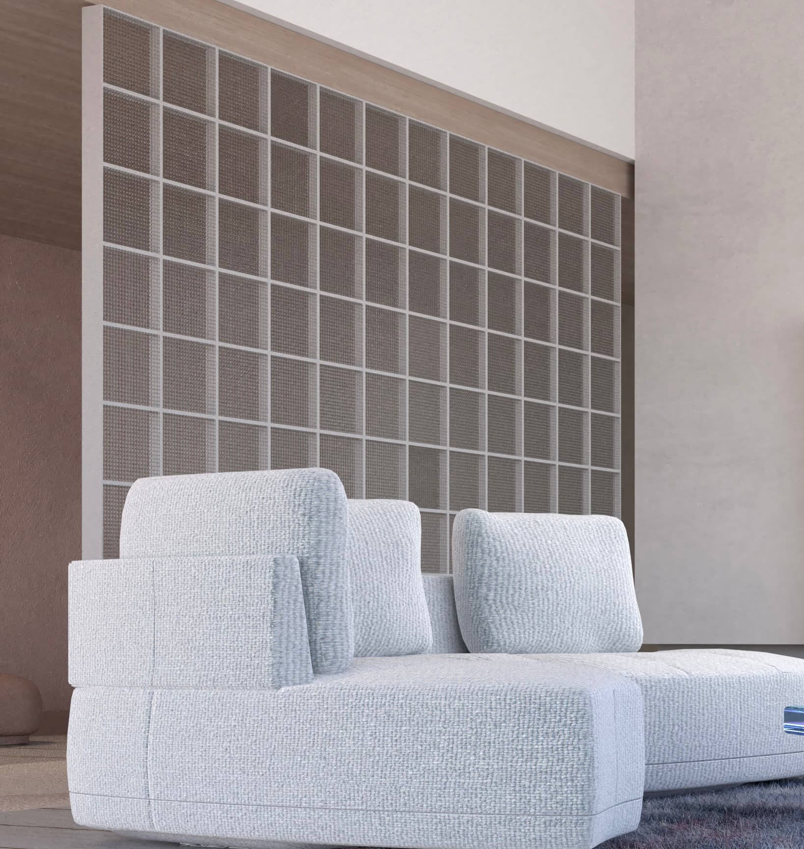

Hello, I am having issues creating a realistic glass block wall in a model I have. I have used a model from sketchup warehouse and changed the material to Glass from chaos, but still looks quite off. Can someone share some tips on how to improve this?
Glass block can come in lots of different colors, patterns, sizes, etc. Do you have a reference image of what you’re trying to achieve? That will help narrow it down.
ex:
Something like this:
I would probably increase the roughness / decrease the glossiness - that will help it look a little more frosted.
Hoe does this look?
