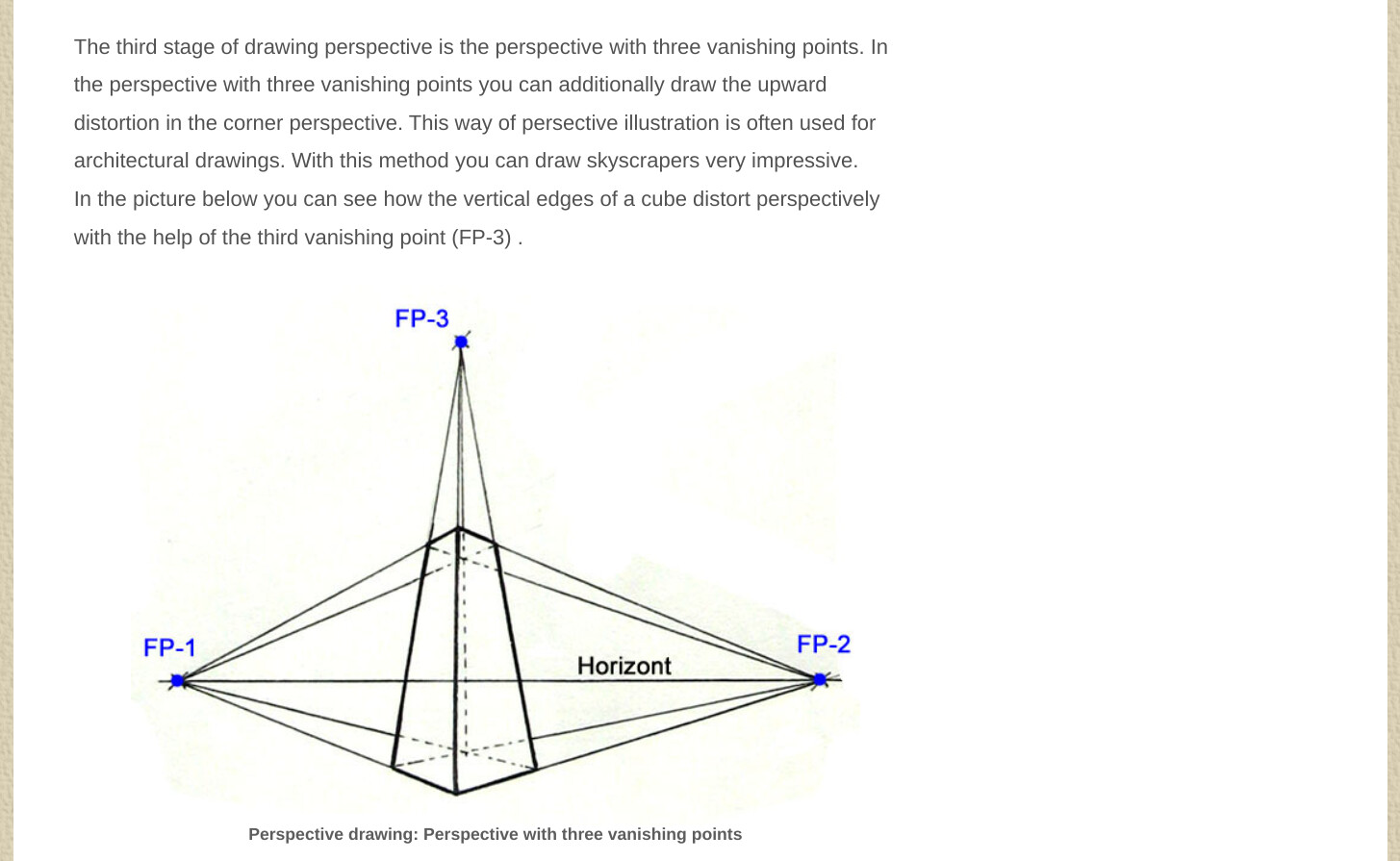

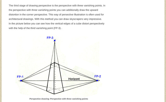

But the vertical lines of the building make it look a bit strange. What happens in a render with ‘Two Points’ perspective and eye height a bit higher, say 1.8 or 1.9 meters?
Thanks, but which vertical lines?
All vertical lines on the building, like wall corners, glass framing.
But sorry, it appears that the render was made with (or very close to) ‘Two-Point Perspective’.
Still, it looks like the top level is tilting over to the left. It would be right at eye height at some 5 meters but that isn’t practical. So maybe some effect of the vertical vanishing point on these vertical lines. Not too much though.

Wo3Dan makes a point, I agree, and you confirmed, it looks like a 2 point perspective because by activating the parallelism, you removed the vertical perspective they’re mentioning.
and because of that, it looks more render-y even though the render is actually quite clean, the same way taking a photo and making the verticals parallel makes the photo look a bit weird
