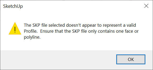

I’ve been trying to build a cavity wall profile in Profile Builder and I thought I had been successful. The attached SKP file shows the profile (from my saved library) which I can create via the assembly dialogue.
Unfortunately when I then try to use the saved profile via the profile dialogue I get the attached warning message. Does anyway know what I might be doing wrong?
Cavity Wall 350mm.skp (97.3 KB)
Profile Builder Invaild Profile Warning
Operator error! I’ve just realised that you can’t use the profile dialogue for assemblies. I thought that the assembly dialogue was just for assembling profiles and once you built the assembly you would access it via the profile dialogue. However, that’s just for single profiles rather than assemblies, hence the warning message.
