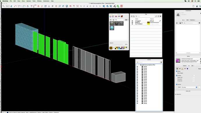

Hi, I am new to sketchup so forgive me if very basic question. I am trying to get to grips with colouring up shapes in Sketchup. I have played around with changing the colour of object colours in the Entity panel as well as in styles. But I am stuggling with which one takes priority over the other. Perhaps the attached screen shot explains a text example when the Entity panel colour is taking priority over the Style colour. Can someone help demystify
for me !!

Materials applied to faces take priority over materials applied to group or component “wrappers”. If you have nested objects (groups/components) materials applied to the child objects inside will take priority over materials applied to the parent object. In most cases it’s best to apply materials to the faces not the object wrappers.

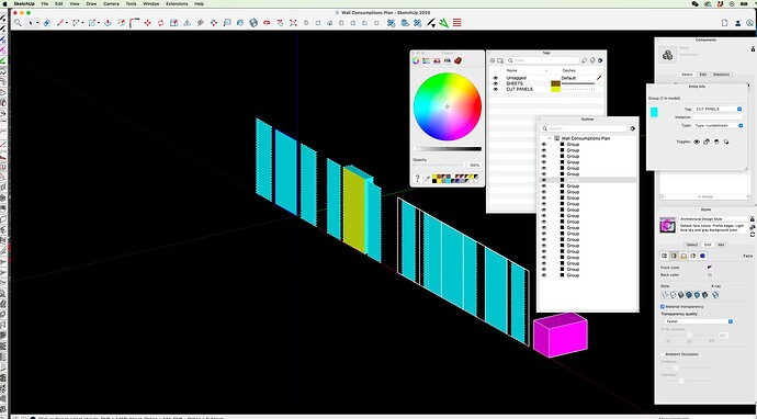

For example the Dashed line in the Tags section is effecting all shapes tagged. But the colour / material is not doing anything… See screen shot. Thanks :slight_smile:
It depends on how you’ve structured the model.
Yes. All groups/components with the same tag will show the same dash style (Note that edges and faces are to be created and remain untagged. Only groups and components are to be given tags)
Correct. Again, you can edit the material if you wish to make a global change without editing the objects. You can also select all of the faces inside an object and repaint them in one click. If you use components instead of groups you can repaint the faces in one instance of the component and all the other instances will how the same change.

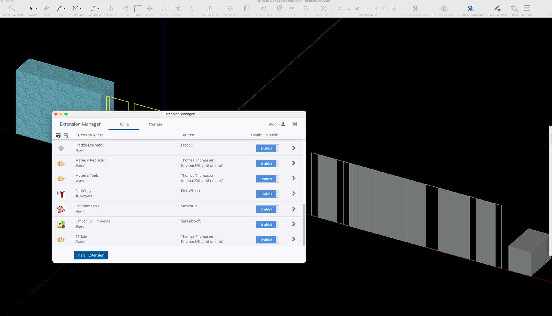

@bmike I installed Material Replacer and Material Tool, but cant see them in the toolbar selector panel. Am I being stupid???
check the extension menu. not all extensions have toolbars or buttons, many work only from the menus or with a right click.
