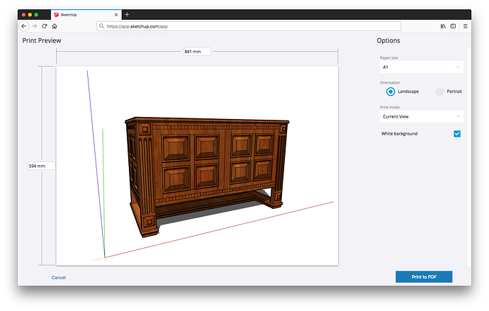

We are happy to announce a new capability for printing in SketchUp for Web and SketchUp for Schools that you can try out today.
Similar to PNG export, our Print Preview utility lets you compose your 3D models in the context of the paper space you’d like to print them on. Go to File > Print to check it out.
You can select a standard paper size, or specify a custom one. Just like PNG Export, you can use basic navigation controls (Orbit, Pan, and Zoom) to position your model on the preview canvas. You can also choose to print with a white background, which we hope will save you a little bit of toner.
Of note, we’ve made model scenes accessible in Print Preview (and PNG export), so you can easily jump to scenes you’ve composed in your model. And if you tweak your scene a little bit, SketchUp for Web will save a default “(Last Print)” scene when you print to PDF. If you want to save this scene, just rename it in the Views panel. Otherwise, SketchUp will overwrite the scene on your next export.
You’ll also notice that we are introducing a Print to Scale mode for paid subscribers and SketchUp for Schools users. With Print to Scale, you can compose 1-page scaled drawings at any scale you specify and you can choose to display the scale at the bottom right of your print. In this print mode, the camera switches to orthographic for scaled prints.

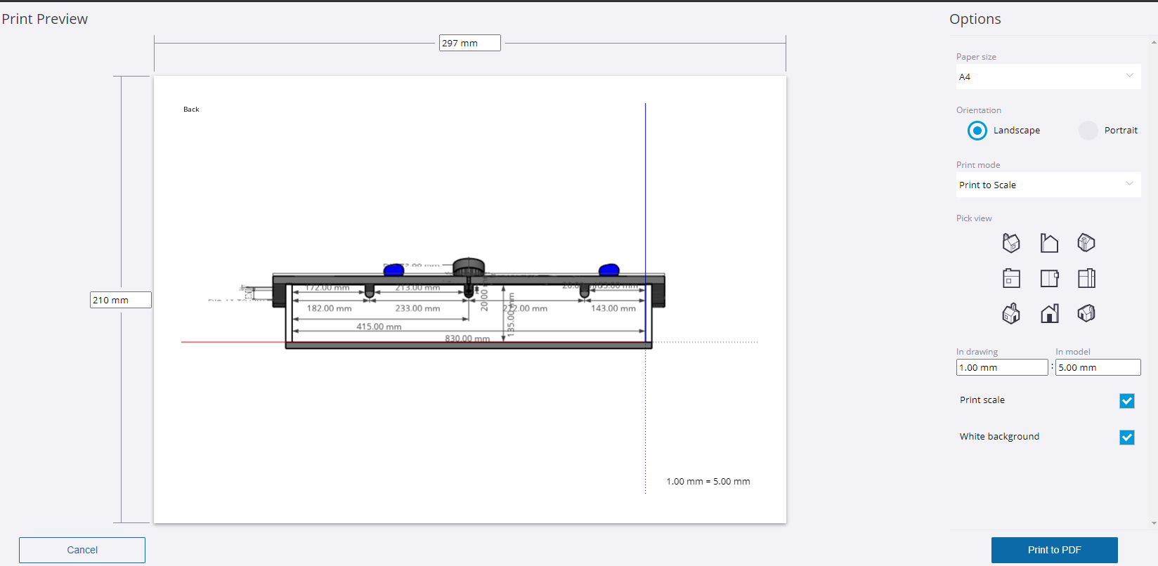

So this is the “table top box” file set up for scaled printing. I’m using Shop but it should be similar for you.
The first thing I did is delete the mess of guidelines. Then I selected the back view and Zoom Extents to make sure of the view.
After clicking Print you can set the paper size at the upper right. It defaulted to A4 and I left it. Under Print Mode, select Print to Scale. No need to pick the view because that’s already set. I selected a scaleso the whole thing would show on the sheet. Remember that “In drawing” refers to the print. As you can see I also selected to add the scale to the drawing in the lower right and make the background white. You could turn off the axes if you want in the Display panel.

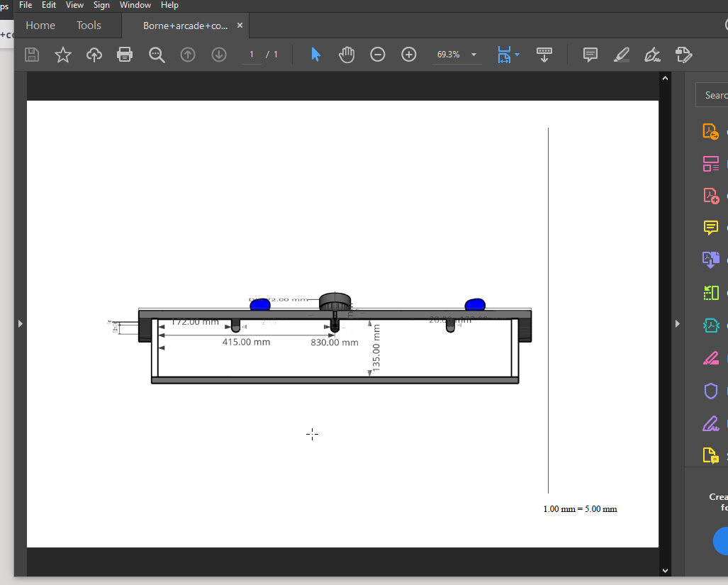

And after clicking Print to PDF, this is what I get.

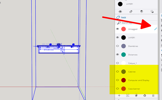

I notice you are using tags incorrectly in the Borne Arcade file. You have made what you called LAYER1 active. The pencil icon should always be set to Untagged. ALL edges and faces should be untagged and only components, groups, and dimensions should get tags. If you use tags correctly, you can hide all the other stuff and leave only the console visible.
Here I’ve created new tags for the cabinet, the computer stuff and the banner at the top so I can show only the console and its dimensions.

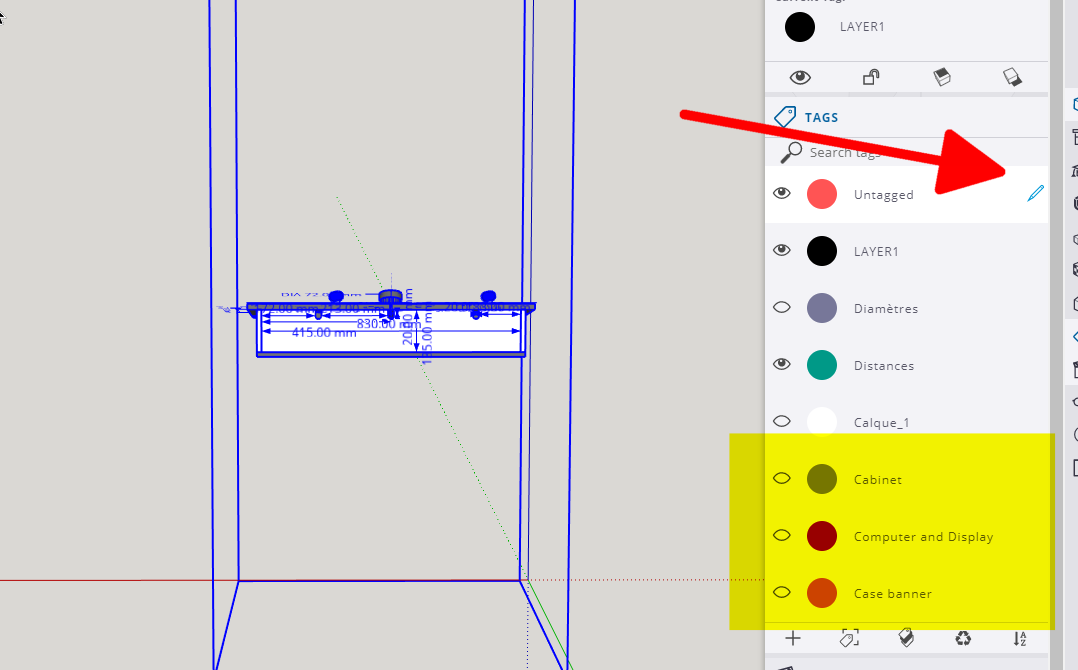

I set up the view to show the back of the console. Parallel Projection, back view, zoom extents. Then I updated your scene. Notice the thumbnail looks as you’d expect.
Screenshot - 12_27_2020 , 10_16_23 AM
Print Preview from this model.
And the PDF export.
That should get you into the shop to build your project. Looks like a fun hobby project. Pretty involved.
