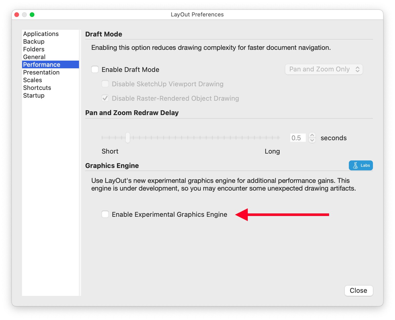

As @paul.millet mentioned earlier, turning off SketchUp’s new graphic engine seems to be the best solution for now. I was able to get results that way from SU 2024 > LO 2024 > PDF with these results:
When I turned SU’s New Graphics Engine back on, it broke not only the new reference version I placed in LO but the previous one above that had just worked moments before.
I’m not an insider or a programmer, but it seems to me from this experiment that what SU is set for matters when you’re in LO and update a reference even if LO is set not to use the new graphic engine and the reference is in principle a file saved to disk.
Going back to 2023 is a way to get to back to the classic graphics engine, but my test found setting everything to classic graphics in 2024 got a workflow that worked, at least on my setup. (MacBook Pro M1 Max and Ventura)
