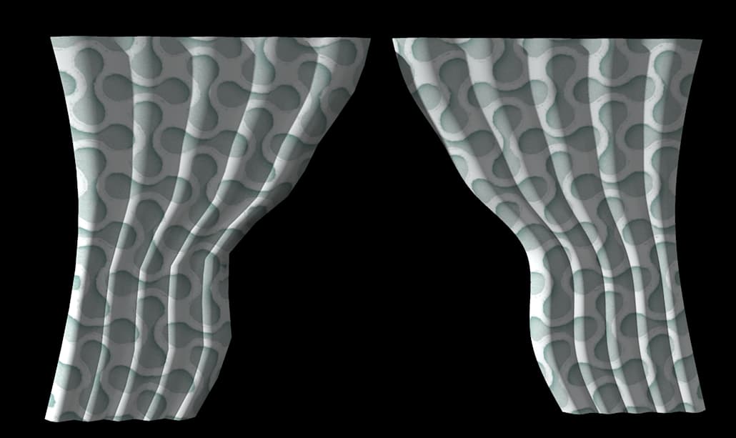

By the way, this is an exaggeration of low poly and over detailed.
The curtain on the left is 700 entities and the one on the right is 77000.
Regardless of workflow and optimizations by modeling.

To be honest, I don’t see that much of a difference in practical point of view. But then again, I’m a total newbie in rendering stuff xD. Still, I guess I know what you mean when you mentioned the room for optimizations before buying a new hardware.
Edit: I think I replied to the wrong comment, it should have been the one with the picture
That was my point, 77000 entities will quickly cripple a model without adding anything useful.
