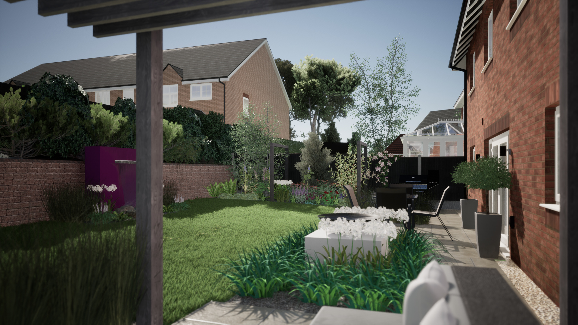

I design all my gardens using sketchup. Create the space and then search for a plant in the 3D warehouse. I generally use the 3D plants . I also create new plants from scratch.
If you are after photo quality renders then you need to use another package such as Twinmotion or Enscape. They take the 3D models from sketchup and with a little work you can create images like the following
FANTASTIC Do you do freelance work to the quality of the images provided if I supplied a basic 2 ariel image? scale is not massively important just a realistic ish image ? If so what would you charge for say something similar to the images you have sent? Perfection and precise plants builldings ect are not what I need . I need someone to create a visual from a basic concept if you are interested ?
