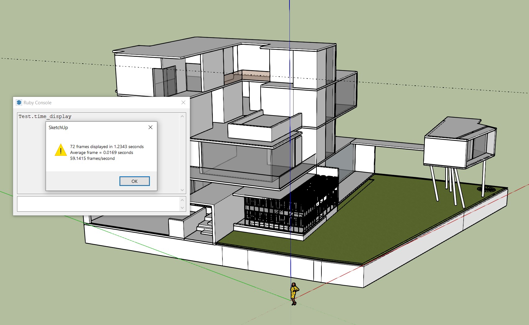

Huh, smooth as silk on my 8th gen i7 based PC (full specs in my user info) even before cleaning up drawing.
Even got 59+ FPS
