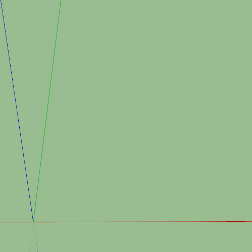

It’s not working! whether I make group or component, I did both! Still wouldn’t work! :confused:
I did it before too since the guy in the tutorial asked for it. I’m new to sketchup, I’m an avid autoCAD user, but I need to start using sketchup now, and I feel helplessly incompetent. I dont know what I’m doing wrong. Lemme look up a way to record my screen to show you all.

file.skp (94.0 KB)
@DaveR
Here you go, sorry it took me a while to realise that skm is the extension name for a sketchup file.
SKP is the file extension for the SketchUp file.
The problem is although you’ve made components of the rectangle and copied it, the shape you’ve drawn is outside the component wrapper. You need to open the component for editing and then draw the shape.
