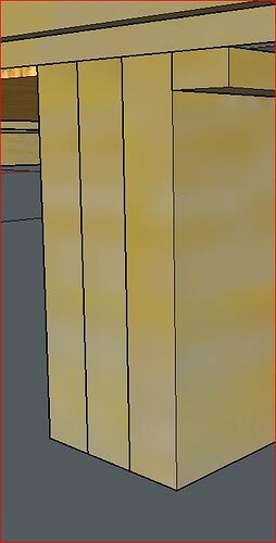

I 'm having problems with the camera views. When I choose ‘Parallel Projection’, I often get problems where most of the model isn’t visible:

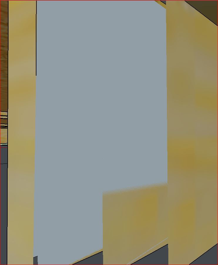

When I use ‘Perspective’, I can’t get close up to areas in the model because as I get closer, the faces and edges disappear:
Normal
Close-up
Could someone let me know what I’m doing wrong here? Thanks.
Do a search on Clipping Planes. Much has been written already.
Parallel Projection is prone to clipping if you orbit.
It’s typically used for creating orthogonal views, not for general modeling.
Have a look at this Help article…
Clipping & Missing Faces — SketchUp Help
You can also change your Field of View to zoom in (Zoom tool, type camera angle or focal length) without moving your camera nearer to the model.
