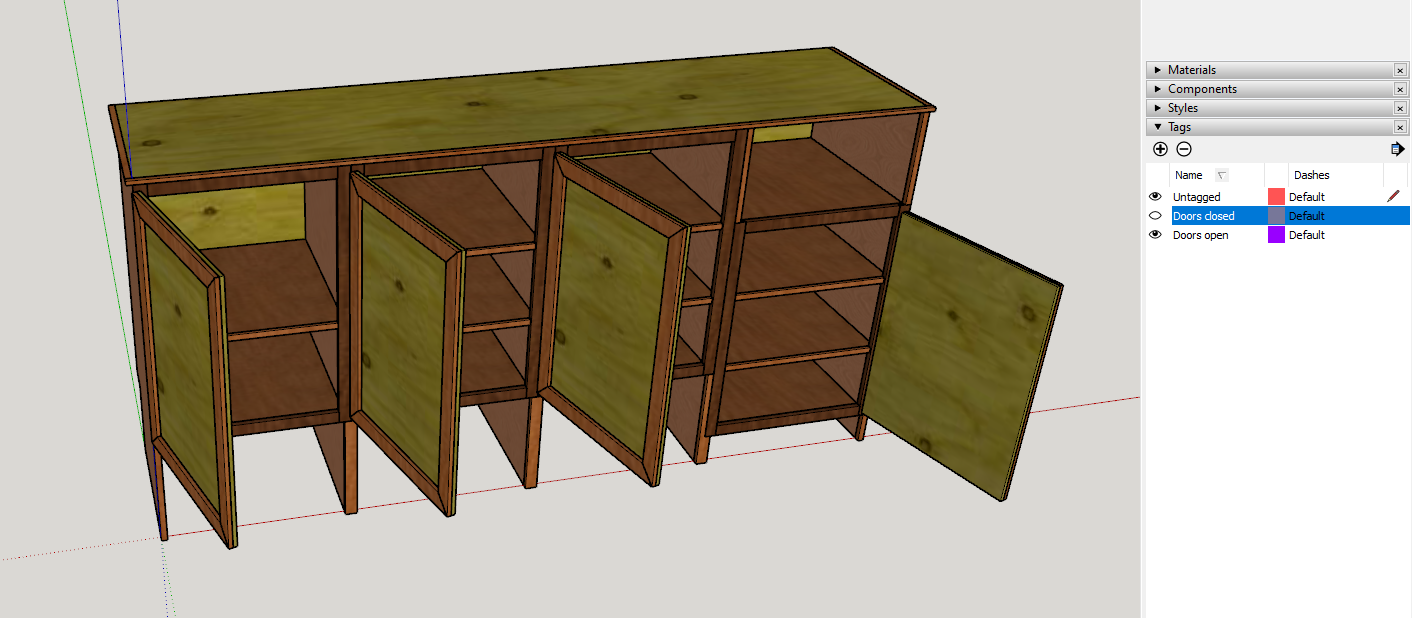

If you want to show the doors in open and closed positioned, you need to have copies of the doors in those positions and assign layers to them so you can show one or the other in a given scene. If you have only one instance of the door, it will show in all scenes in the last position you put it. Scenes don’t animate objects. They animate the camera.
Here I’ve done a quickie showing what I describe above. Two sets of doors; one closed, one open. Two tags/layers created. All the open doors get the Doors open tag/layer assigned to them and all the closed doors get the Doors closed tag/layer assigned to them. Switch which ones are visible in the Tags/Layers panel.

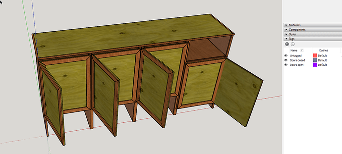

When you create them you can type the name or you can double click on the Layer name and change the name. When you first click on the + in the circle, the tag/layer is created and the field is selected for editing.
