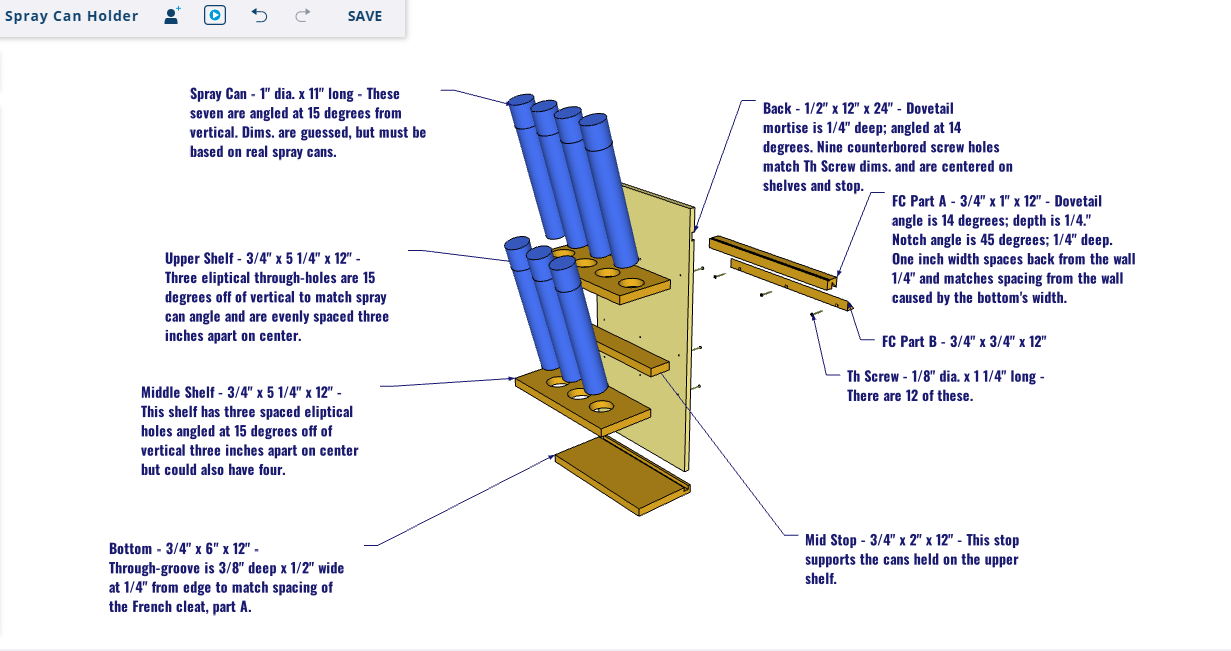

A. Spray Can Holder #1.skp (278.1 KB)
This is my version of another Woodsmith Magazine idea for a spray can holder.

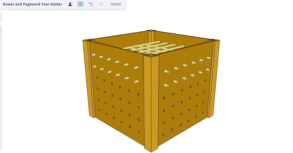

A. Dowel and Pegboard Tool Holder #1.skp (253.1 KB)
Tools like chisels and screwdrivers can stand up between dowels on the inside of the tool holder and small tools can be hung on the outside. Alternatively pencils and pens on the inside of the holder and keys on the outside if used in the kitchen.
Edit: To give credit - this was a Woodsmith Magazine idea from a subscriber.

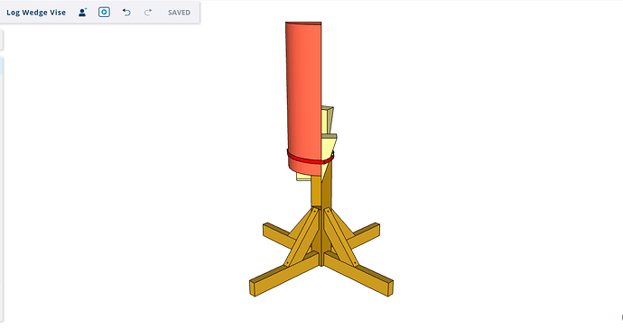

A. Log Wedge Vise #1.skp (132.8 KB)
I’m working on a Eastern red cedar log now. Every time I saw a log into boards, I try to dream up another way to hold it. :sweat_smile: The component called band could be a ratchet strap or a rope. It was easier to make a band.

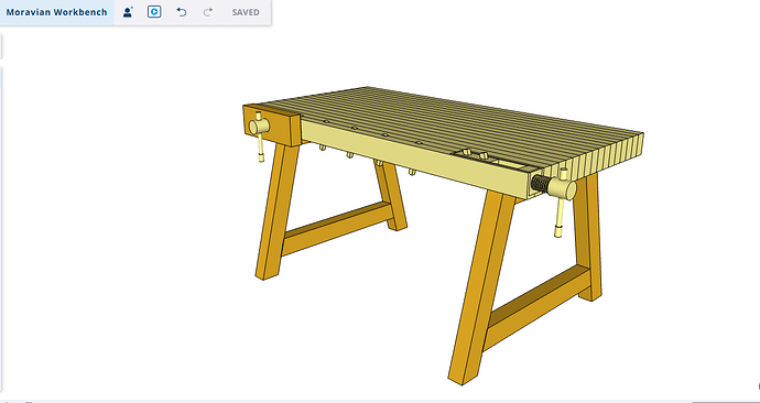

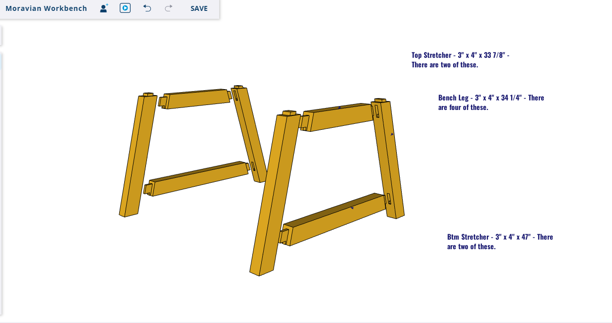

A. Moravian Workbench #1.skp (574.7 KB)
I have made a model like this before but here I have added the vises and dogs.

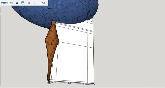

A. Decoration #1.skp (517.8 KB)
Why not start something. If anyone wants to make their own Christmas tree decoration, put it on the forum. Then someone can model a tree to hang them on - or not.
