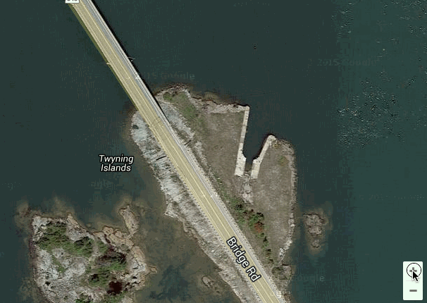

after adding a Location, the button tooltip changes to ‘Add More Imagery’ [not Add Detail, sorry]…
before selecting the area, you can zoom in or out with +/-, if you start a small move, you can use the arrow keys to navigate a set amount…
i.e. first selection 12 clicks left, 12 clicks down
then for the next one, 24 clicks left, 12 clicks down
the number of clicks will depend on your import, so it can take a couple of goes to find the best overlap…
to be honest it was easier when it had the direction toolbar, but arrow keys still work ok…
