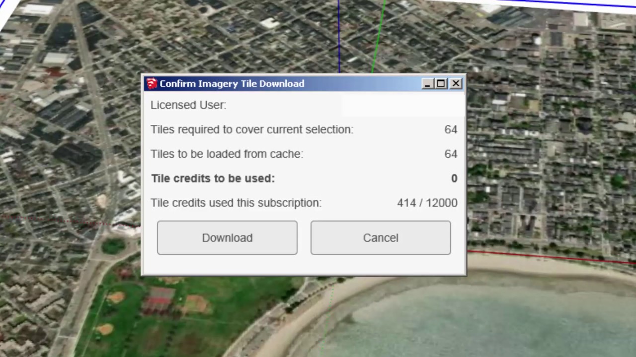

Sounds like you would benefit a lot from PlaceMaker. This is how the PlaceMaker high res aerial import works.

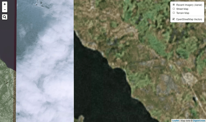

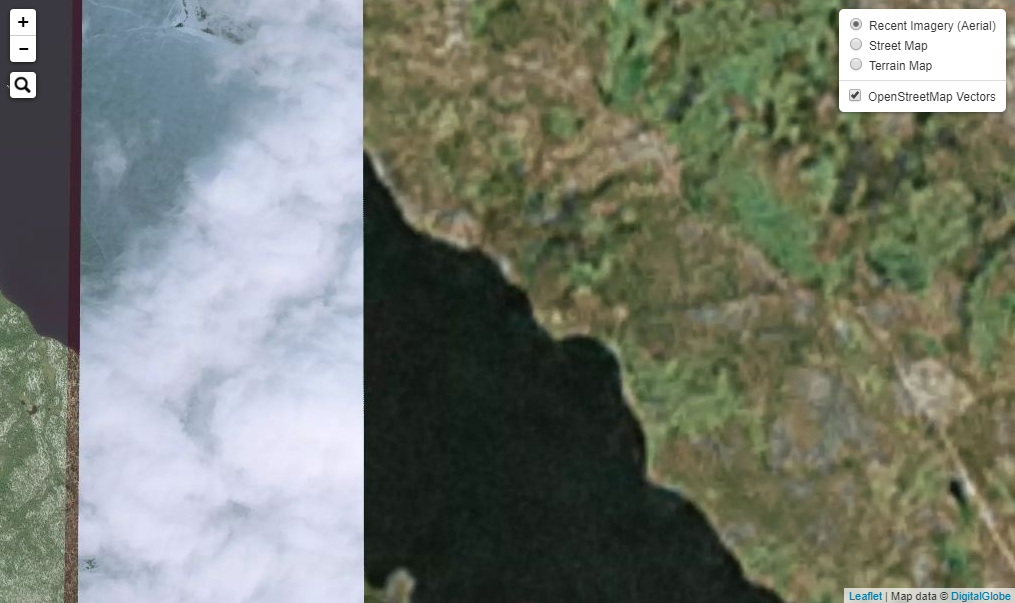

You can preview the PlaceMaker imagery quality here:
The imagery that you can see here is the exact same imagery that you would get if you purchase PlaceMaker
Ouch, for the area I’m currently working on it seem it’s completely unusable.
I can’t even tell roads or houses apart from terrain in the smudge, and a row of data seem to be taken at winter time.
