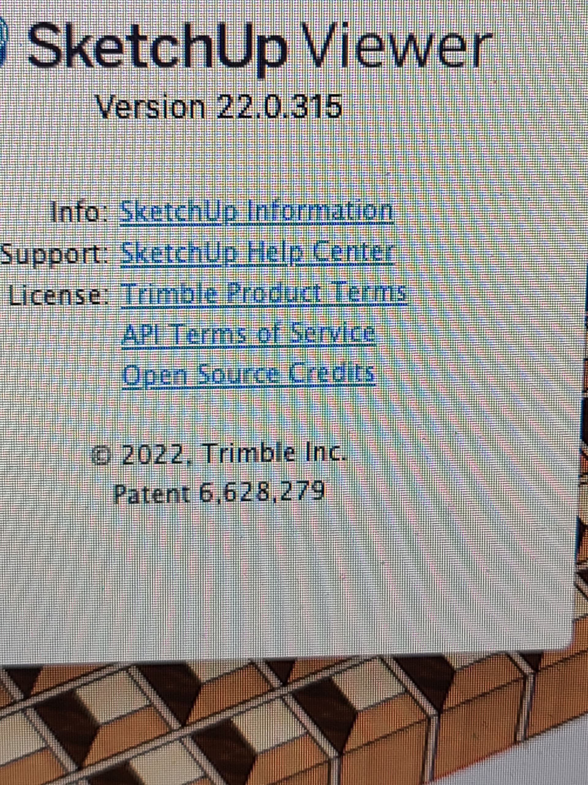

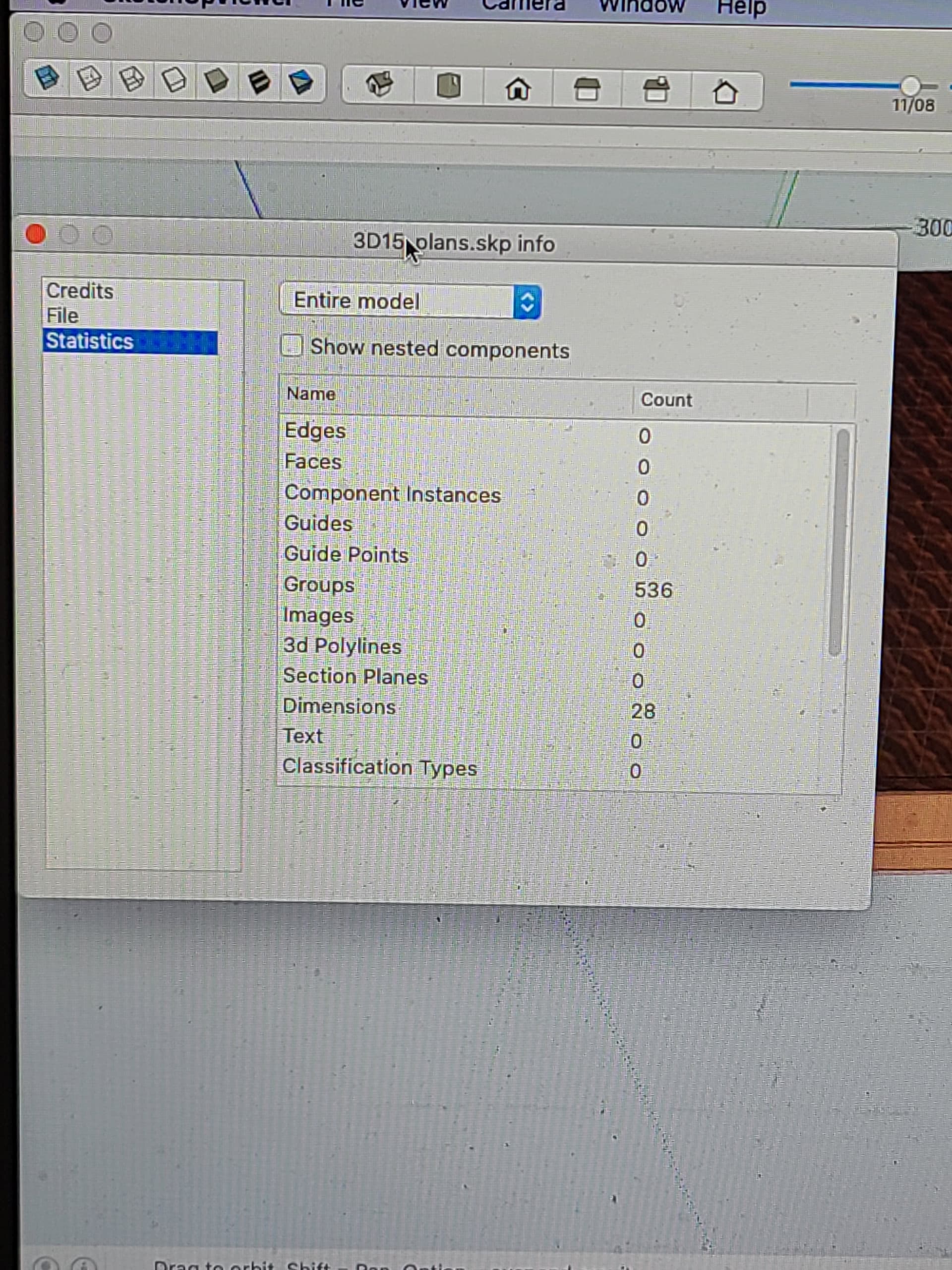

Thank you for your reply. Attached are screen pictures from my Apple MacBook Air. The pictures show the Sketchup version and the Model Info where Units doesn’t show. I hope it helps.

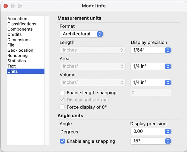

Under model info, units should be on the left hand side list at the bottom if you are using the desktop version.

There’s clearly something wrong with the installation of SketchUp on your computer. Did you actually install it?

The problem is you’re using SketchUp Viewer, not SketchUp the modeling software.

Again, there’s something wrong with the installation of SketchUp or you didn’t actually install it. The Model Info window should look like the one in @endlessfix’s screenshot.
Her screenshot shows she’s downloaded Viewer.
Monospaced identified your problem. You didn’t actually download SketchUp 2022. The Viewer doesn’t allow changes to the moddel including changes to the units.
