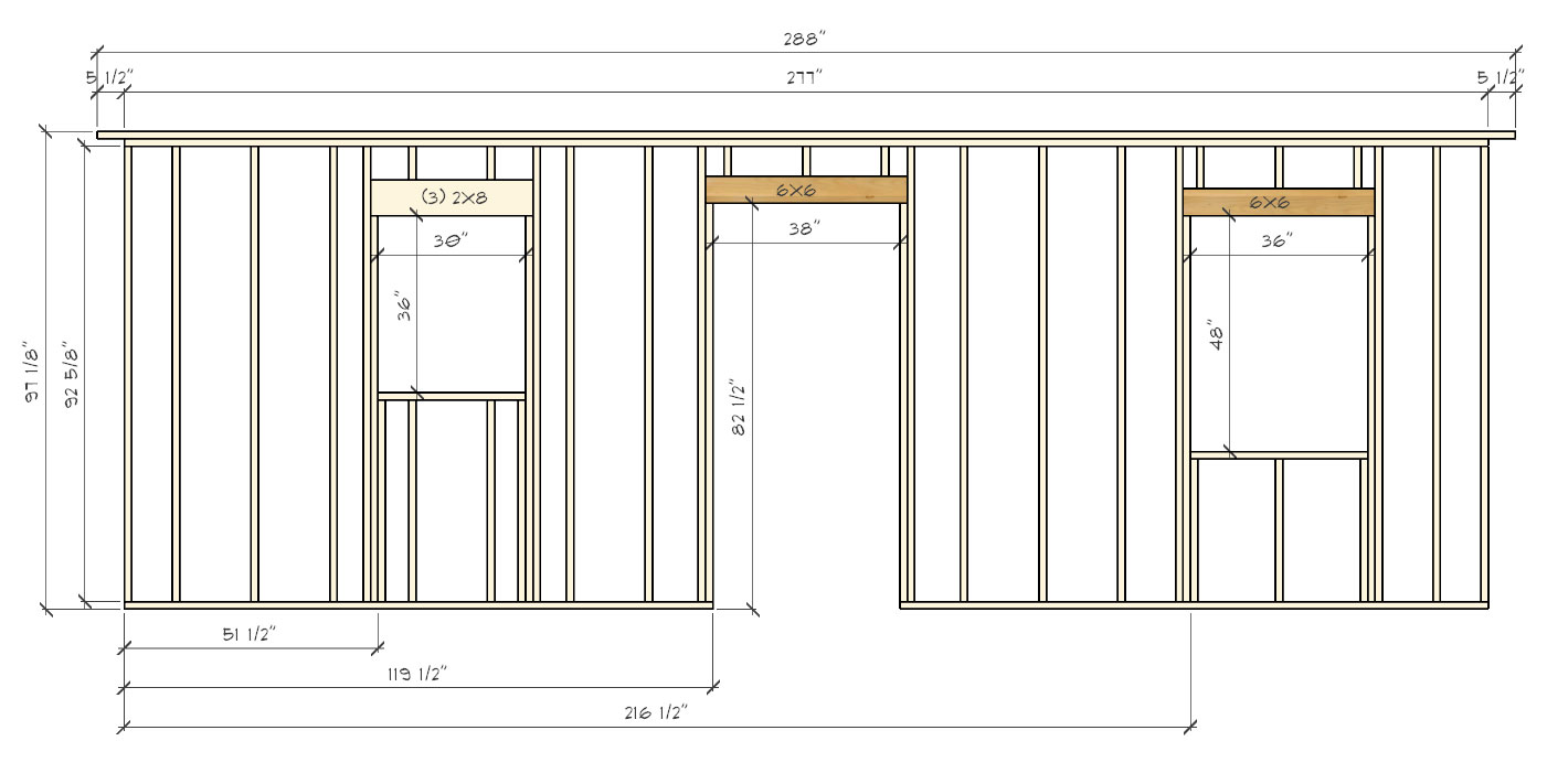

Here is another screenshot showing the inclusion of header callouts (text). I’m able to set the insertion point of the text and vertically I can adjust it perfectly however there does not seem to be a way to specify the justification of the text (left, right, center) so the user may have to make some minor adjustments as they bring the scenes into Layout:
Note that all of these dimensions and text callouts are being generated automatically by the plugin. When a wall panel is regenerated or modified the dimensions are updated accordingly. So any manual modifications will be blown away if you change the wall up. This of course is good and bad to some extent.
Good because it is fully parametric, bad because manual mods to the auto dimensions will not be retained if the wall is regenerated/modified.
Hopefully this feature will be a time saver for those needing to generate framing plans.

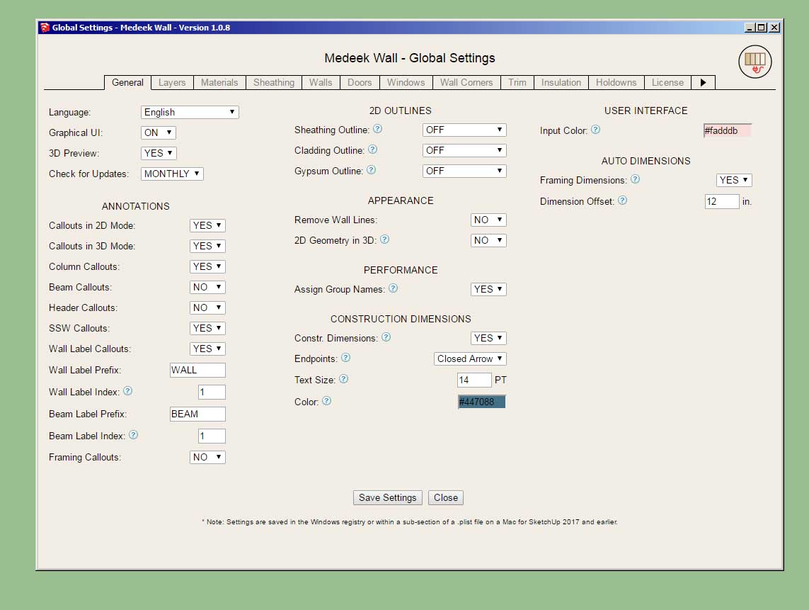

Version 1.0.8 - 03.12.2019
  • Enabled auto-dimensioning for wall panels (to be used in conjunction with the Scene Generator for creation of framing elevations).
  • Added the Dimension Offset and Framing Dimensions parameters to the General tab of the global settings.
  • Added Dimension Layer 4 specifically for auto-dimensions (Layer tab of the global settings).
There is probably quite a bit more to be done here with auto-dimensioning of framing elevations, but at least I’ve taken an initial crack at it. We will see what the feedback is from my production builders and component manufacturers and then make any needed course corrections.
The model can get quite cluttered (and ugly to be honest) with all of these dimensions floating about. If you have layers enabled (which I highly recommend) then you can turn off the dimension 4 layer in the SketchUp layers tray and only toggle them on in the scenes that need to show the framing dimensions. This will remove the clutter from the scenes that you are primarily working in.
To further increase performance I would actually suggest not enabling the auto-dimensioning until you are at the tail end of your primary design phase then toggle it on in the global settings and regen your wall panels and they will then show all of the framing dimensions. From there proceed to generate your scenes for the framing elevations.
Some designers prefer to apply their dimensions in Layout rather than bringing them in from SketchUp. For that reason the Framing Dimension parameter exists and allows one to choose to enable or disable this feature.

I’ve made a few small changes to the icons of the primary toolbar with Version 1.0.8. Unless you are running 4k resolution (UHD) you will probably not notice any difference or you shouldn’t notice any difference. I need some feedback from both Windows and Mac users to see if my “fix” for the toolbar icons will work. Once I am assured that it is effective I will proceed to update the rest of the toolbar icons.
See API development thread here:
Version 1.0.8b - 03.13.2019
  • Updated toolbar icons to be compatible with 4k (UHD) resolution monitors.
I have decided to go with the simpler solution of upscaling the icons by 2x in size rather than switching to SVG and PDF icons. The toolbar icons should now render properly with 4k (UHD) display devices.
