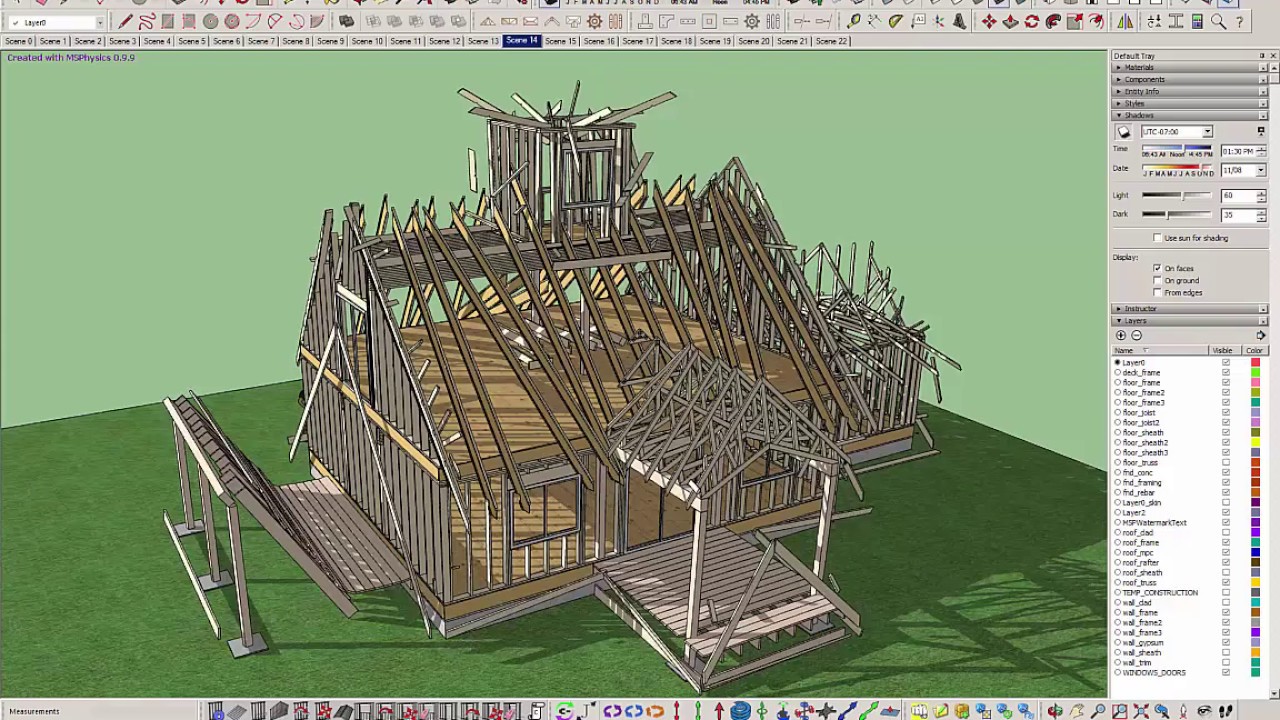

Medeek Truss vs. MS Physics:
Pretty clear the house didn’t have a chance.
I’m actually very impressed with the collision detection of MS Physics, an amazing extension.
I’m sure that it wouldn’t have fallen down if you added a few pins from a finish nailer here and there! :wink:
Looks funny that the subfloor stayed together.
Nicely done however.
Shep
Version 1.8.7 ? :grimacing:
I ungrouped everything except for some of the trusses. Without the nails this would be the fate of any house.
Kind of fun to watch a bunch of trusses domino each other, probably educational for an installer to better illustrate what can happens when you don’t properly brace your trusses.

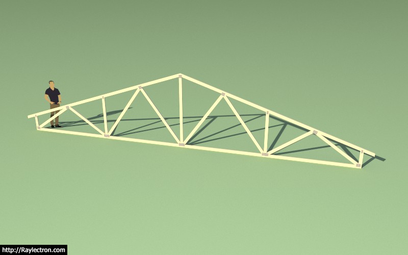

Fun with Roofs - Episode 1
My 9 year old son took one look at this roof and then said “Don’t build this in Florida, you’ll create a sink hole”.
