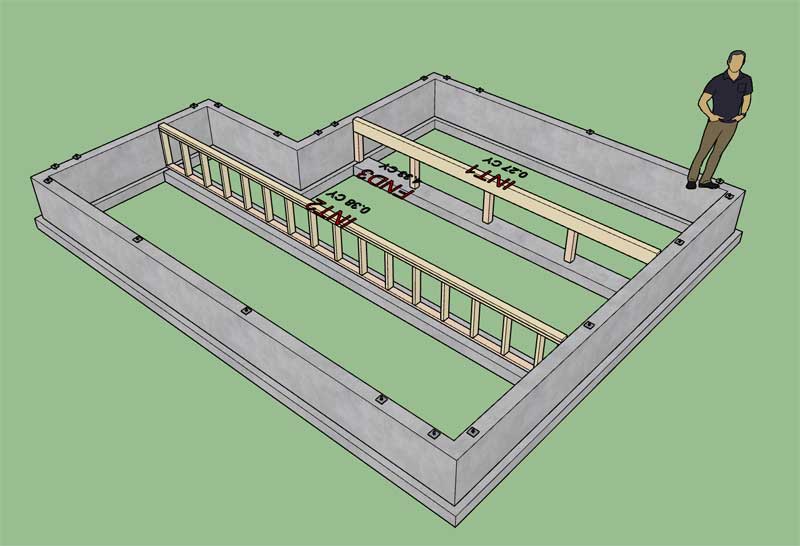

Parameters for the new Interior Bearing Module:
Basic Options:
Bearing Type: Post and Beam, Stud Wall, CMU
Bearing Height:
Footing Width:
Footing Depth:
Ftg. Offset Start:
Ftg. Offset End:
Sill Plate Offset:
Stemwall Offset:
Rebar Option: Yes/No
Post and Beam Options:
Beam Width:
Beam Depth:
Post Spacing:
Post Width:
Stud Wall Options:
Stud Depth:
Stud Width:
Stud Spacing:
Top Plate Qty: 1,2,3
Top Plate Thk.:
Rebar Options:
Ftg. Bar Dia.:
Ftg. Bar Qty.:
Let me know if I’m missing anything. I haven’t included a section for CMU yet since I need to do more research on that particular construction type.

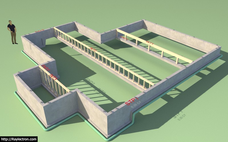

Version 1.4.1 - 09.04.2019
  • Enabled the “Draw Interior Bearing” tool with the following support types: Post & Beam, Stud Wall.
View model here:
Now a video demonstrating the polyline stemwall, interior bearing and step tool all working together would be interesting.

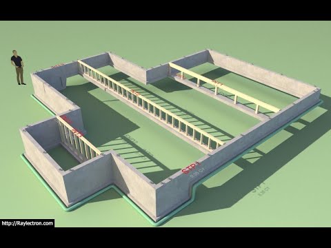

Tutorial 6 - Polyline Stemwalls, Steps and Interior Bearings (13:27 min.):
View model here:

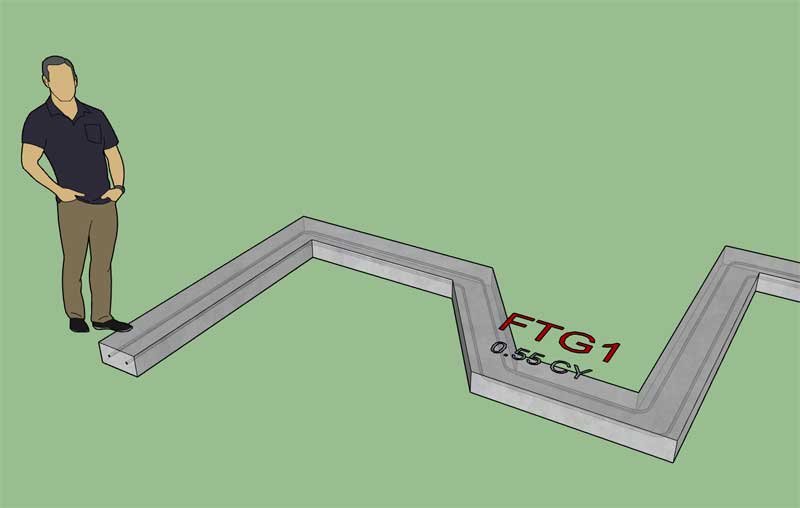

Version 1.4.3 - 09.07.2019
  • Enabled the “Draw Strip Footing” tool with the following advanced options: rebar, drain pipe.
Similar to the polyline stemwall tool you can create closed loop polylines (polygons) as well as simple linear sections of footing.
Similar to the polyline stemwall tool the point selection of the tool is terminated with the “DOWN” arrow key.
The horizontal bar option is shown in the menu but is currently not enabled. I need to give this option some additional consideration before I make it live.
