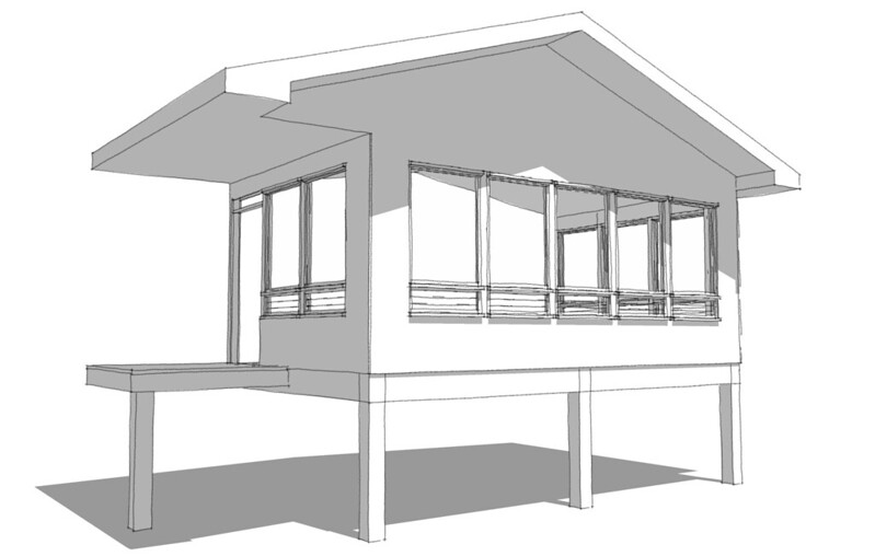

Your builder may not really need a ton of information. Some years ago we had a screen porch built to replace the deck on our house. I made a simple SketchUp model to show the contractor what we were thinking.
No construction details at all. I didn’t even bother with the stairs.
This is what he built.
