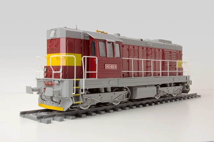

Hi,
this is my new model of diesel locomotive type 742 called “Tomcat” (I dont now why), which is used for mainly freight transport. The model is in the scale 1:25 and it’s possible to use it on garden railway in G-scale (designed for PIKO 36105 carriages). I drawed it from scratch in Sketchup 2020 Pro and printed on Prusa MK3S printer.
Here are some pics of WIP, visualization and final photography…

Render:
Photo:

Absolutely fantastic! I’m amazed the Prusa MK3S can make those pipe railings or some of those textures.

Thank you all!
The railing on the sides is divided to plannar parts and the railting in the front and back is printed with overlaps around 30° and with local supports.
