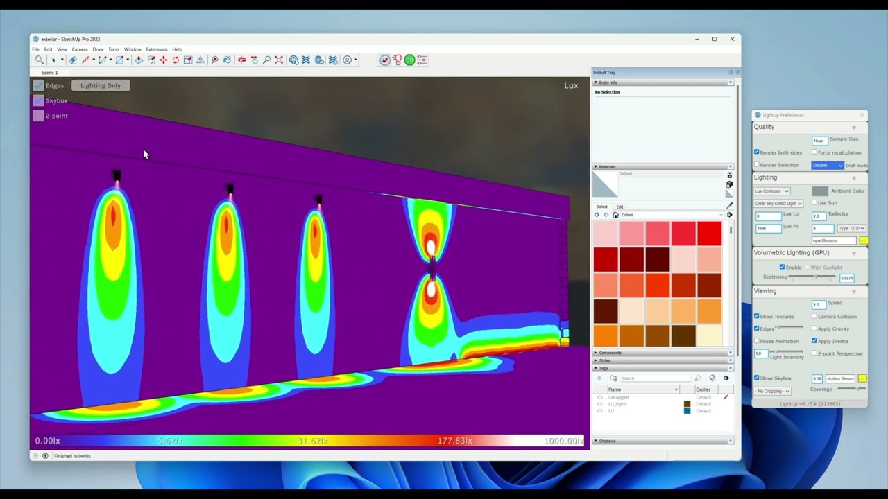

Recorded a quick video which hopefully will help.

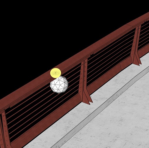

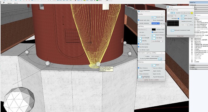

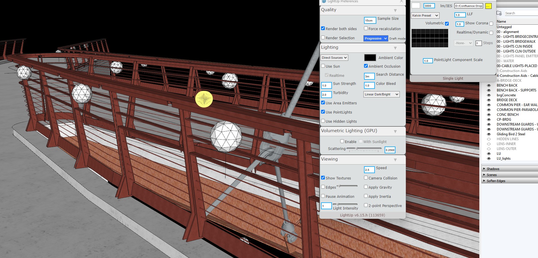

Another question. Please see the attached screenshots.
When we select the light source, the IES profile is not matched to the location. It is impacting light and we notice it lighting up the top of surfaces.
Is it possible to get more accurate with the placement of the IES profile cones relative to the light component?
Thanks for the help.
Daniel
(attachments)
Thanks for the heads up!
Yep, I think this is related to a problem with SU2024 around the cursor hotspot not being honored initially.
Will look into it.
Adam
Ok, should be fixed.
Download your LightUp installer again to get update.
