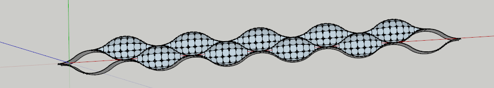

Use the arc tool to draw two semicircles of the same size, and use mirroring to make the two semicircles tangent.
Mirror again

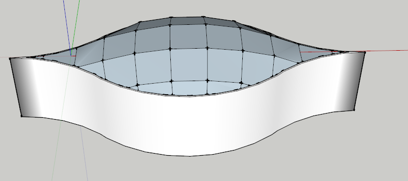

Use the offset tool to offset the inner wall. Then use the push and pull tool to pull out the thickness.

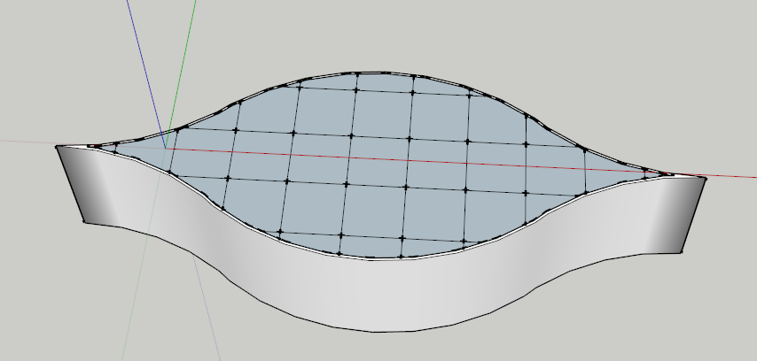

Use soap skin bubble to adjust plane tension.
Soap Skin & Bubble Plugin - Sketchup Warehouse -

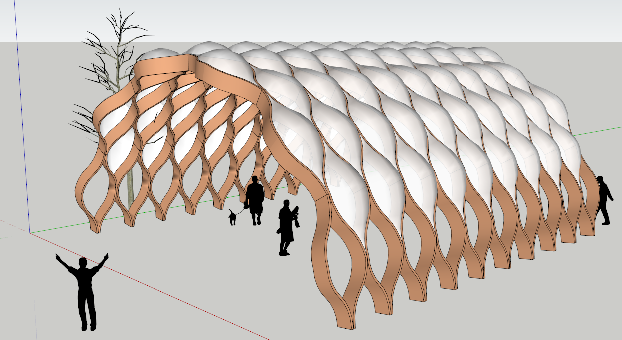

Create component and copy
Bending models using FredoScale and rotate
sketchucation.com/plugin/1169-fredoscale -
Add material
