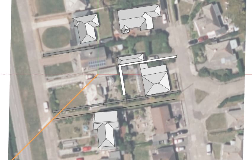

I have a project that I have been working on and have used the Add Location function which worked to begin with but has now lost its true north orientation.
Image below shows my model with true north (which is not correct)
Image below is from a new test file with the same location setting and the true north as it should be.
Under model info and Geo location they both have the same settings.
I’m at a loss on how to fix this.
