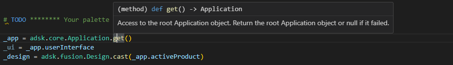

Yes. And just to provide some context, for example: in my Python code for Fusion 360 in vscode, I get helpful pop-ups when I hover over Fusion 360 core API classes and methods. Additionally, when I use Ctrl+Click, it takes me directly to the actual definition of a class like ‘Application’.
Class Application definition:
Maybe this can’t be achieved in vscode with SketchUp API! I’m wondering if there’s an alternative way to navigate through the code and glean information from docstrings without constantly referring back to the official documentation website. It’d be helpful to have some context while programming, even if it’s just a glimpse of what a class or method is about.
