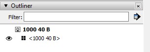

I saved the component into it’s own file using “Save as” 1000 40 B.skp
I then import the component from that file into a model from File/Import. (Same thing happens if I save in Library and select it)
In the file 1000 40 B.skp the component is as below (If I open that file)
When I import it into a new file eg Sketchup template Architectural it is shown as below.
Now your component has an extra nesting layer that you indicate to explode immediately when you apply it in a project.
Basically this shouldn’t be necessary if you just store the correct component correctly in your library
If you select the component you want to save in the library, right-click, and then Save As… from the context menu, you wouldn’t have an extra nesting layer. Unless you save a nested component of course.

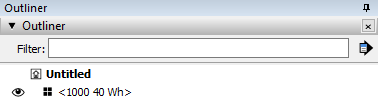

Here’s an example of what my Outliner looks like when I import the saved component into a project.
For this example, I saved the component “1000 40 Wh” from my previous post.
